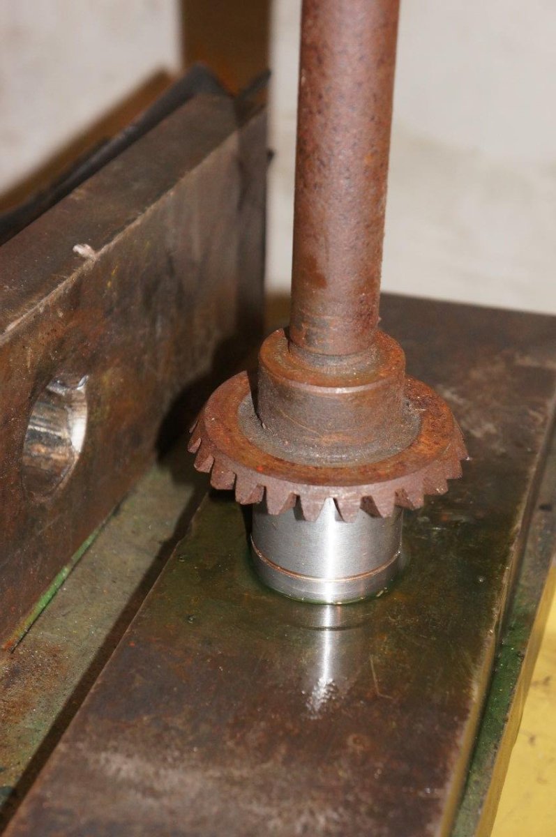

by John E. Guitar
Here's my setup to remove the half moons. You can't see the top of the shaft very clearly but it has a nut on it to protect the thread.
The highest I've had to go is around 15 tonnes.
