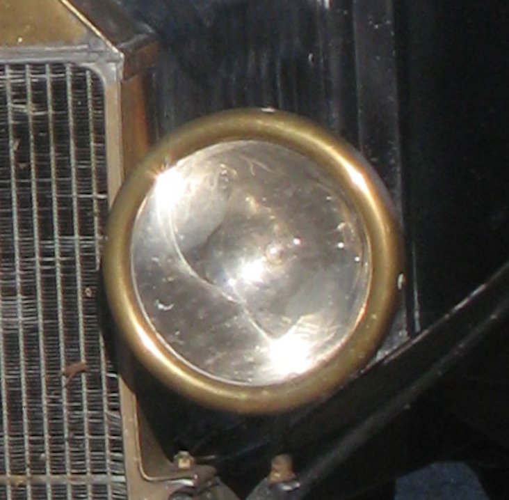

Heck I have the 26/27 brass ones on my 21. They had the plating stripped off when I got them. Right now they are sorta tarnished, but will give them a shine up before the tour season starts, the old girl need a bit of bling.
