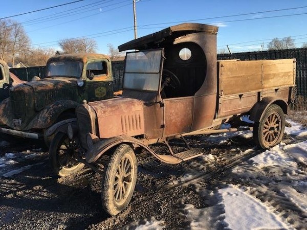

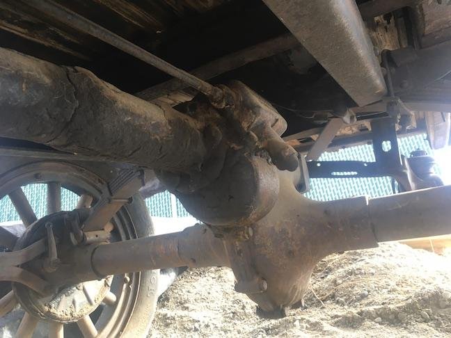

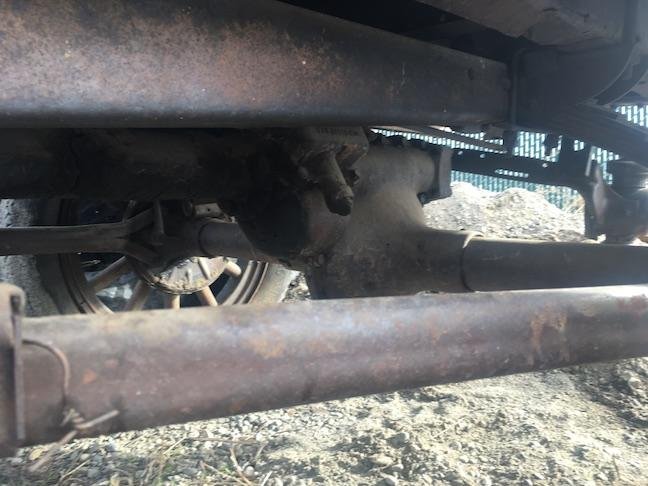

Anybody know what this is?? It's on a C Cab TT a guy in Billings is getting ready to sell.
2020 1 25 tt truck It's not mine, I can probably get some more info but I think at this point he just wants to know what this trans is. I don't recall every seeing one like it. transmission.JPG

Right its not a Lincoln brand TT accessory.
Dropacent
Posts: 3384
Last Name: Morsher
Location: Norwalk Ohio
fuller trans. TT REAR AXLE AUX TRANSMISSION ID
Post by Dropacent » Sat Jan 25, 2020 2:51 pm
It’s not a lincoln, as I have one on my Tt. I believe it’s a Fuller brand, made in Kalamazoo. Not 100% sure , but an educated guess. I had one 20 years ago, and was able to remachine it a bit to make it an overdrive. I’m starting to forget more than i remember.
