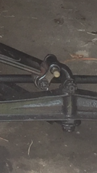

Which is correct?
Nuts or shackle forward?

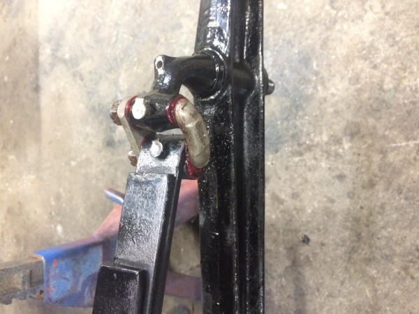

Topic author - Posts: 263
- Joined: Sun Jan 06, 2019 2:50 pm
- First Name: DEAN
- Last Name: YODER
- * REQUIRED* Type and Year of Model Ts owned: 19tour,24tour,25rdpu,27rd.26coupe,TT's,& tractor conversions
- Location: Iowa
Re: Which is correct?
My earlier photos prove I have done it both ways.
I like the look of shackle forward. The way I did it this time.

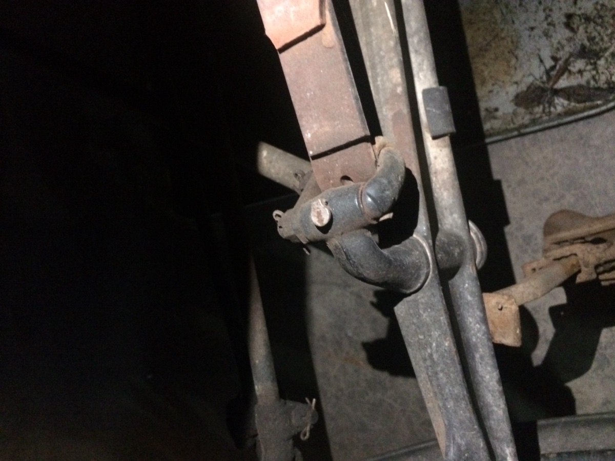

With our Canadian sourced cars, most came with forged L shackles, two pieces exactly the same. The question then becomes is the one nut at the front of the car at the spring eye or the perch?
- Posts: 6341
Good thing nobody asked if the top one has the nut to the back for L-style, Figure 8 and Mae West.

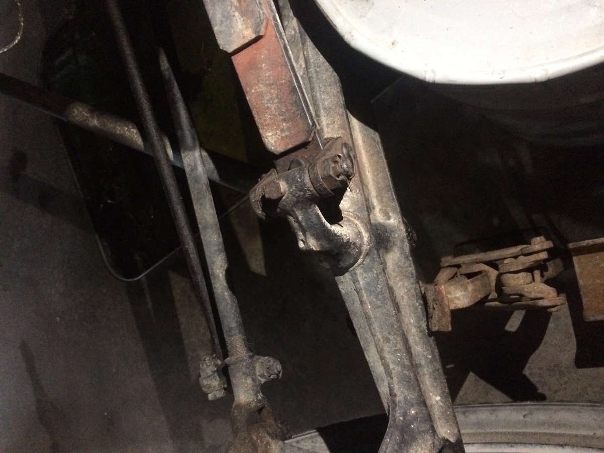

I turned mine around from how they are in this picture because I read on here the oiler facing the rear is supposed to be on top so you don’t have to climb under the car to put oil in.
Maybe a close up of a factory photo would show how the later style were installed originally.
- Posts: 5263
From what I've seen on early brass twist oiler cars (my '14 included) is the oiler is on top at the rear and towards the bottom in the front so as Corey alluded to that makes oiling easier.

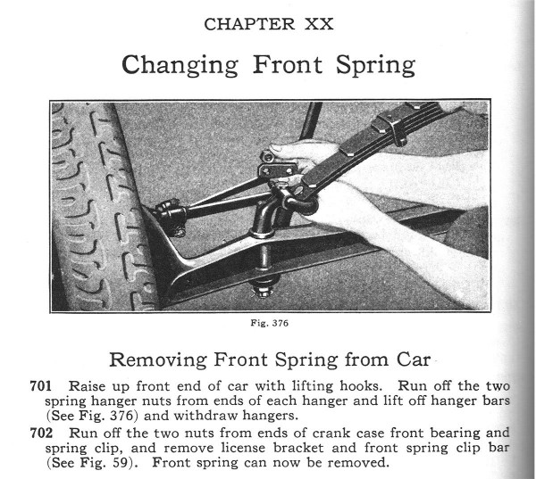

This is how the Model T Ford Service manual shows them. A photo of the rear axle shows the nuts toward the rear also. That makes the nuts more accessible to the mechanic that does the front version.
While it might be nice to establish a correct direction for reference I hope nobody loses too much sleep over it.
Fun to discuss.
I would bet than more than one car came out of the factory the other way. Even more from out of the dealer after repairs.While it might be nice to establish a correct direction for reference I hope nobody loses too much sleep over it.

The service manual illustrations show the nuts to the rear on both axles.
