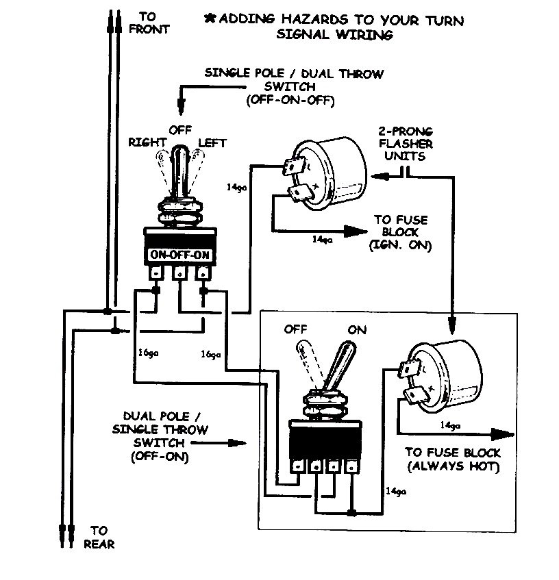

Here are some previous posts on the subject.
Screen Shot 2020-01-24 at 10.22.40 PM.png (19.79 KiB) Viewed 6172 times
NOTE: In this diagram the right/left switch should be labeled ON OFF ON.

One using a horn button housing and one using a modified PVC pipe "T". If you are going to combine the turn signals with the brake light using the schematic above you will have to add some diodes to isolate the front from the back.
