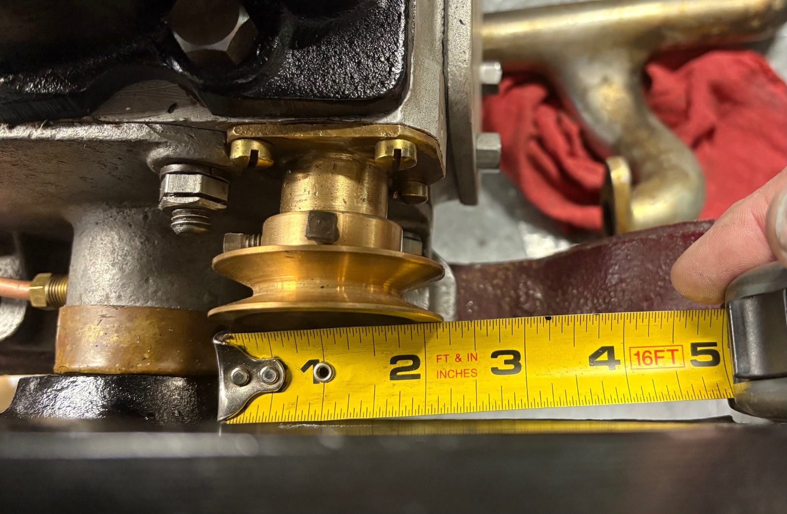

First question from my side at this moment.of someone could measure the diameter of the pulleys of the oiler and the one at the engine side

Will measure for you later today

It just so happens that I have the McCord Oiler for my 1908 Model S Roadster on a bench at the moment so I took a picture of the pulley with a tape measure next to it.
The S Roadster’s engine is on another bench nearby, so here is a picture of the drive pulley.
Hope these are useful,
Trent Boggess

Thanks a lot for the pictures, this helps a lot. Does someone has the small gear in the oiler for sale? Or eventually a complete mc cord oiler
