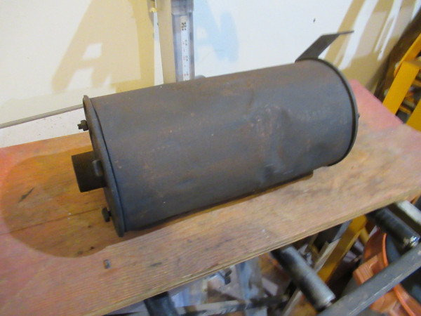

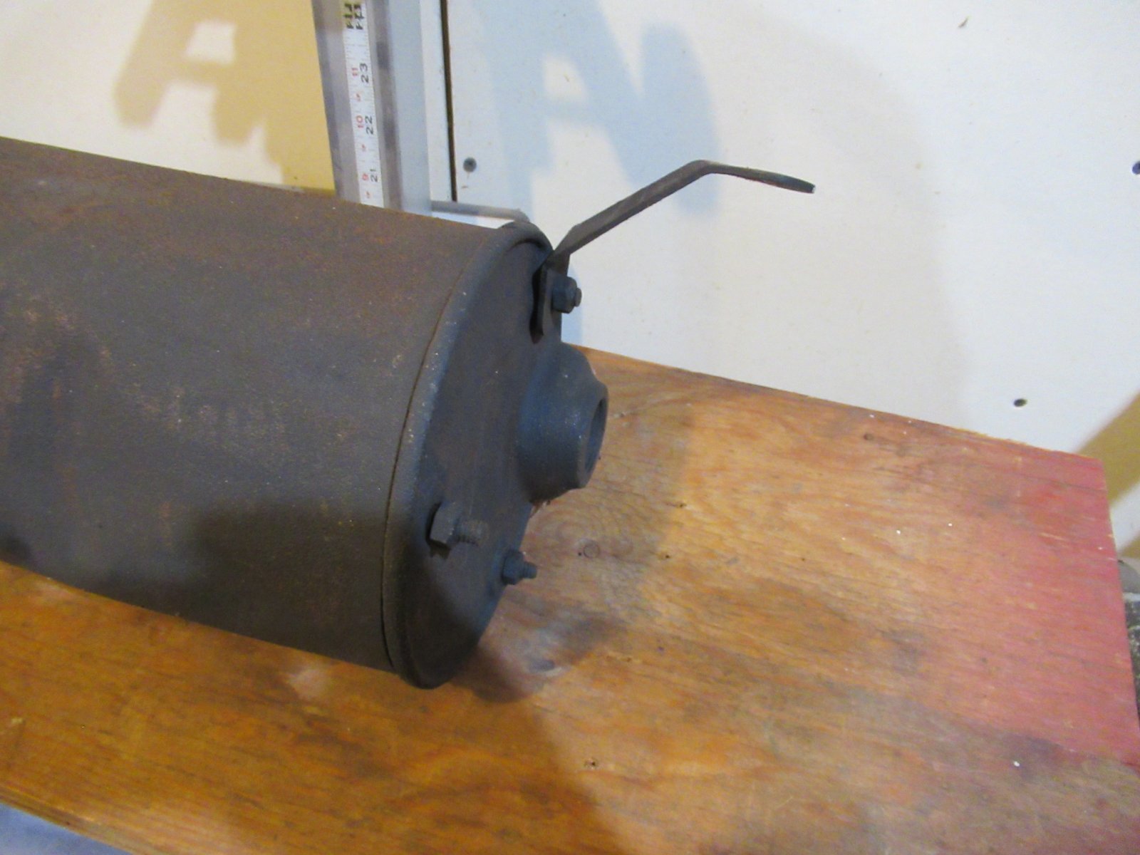

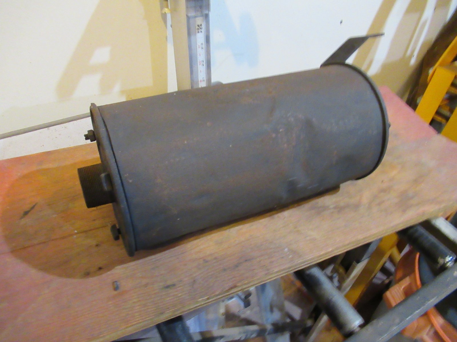

Does anyone have a picture of where/how the muffler on a 08 SR attaches to the chassis? I have the tail pipe and muffler, and the muffler has a bracket that ia bolted on, with a bolt hole, but don't see that the hole lines up with anything on the chassis. Is there another piece to the bracket?
thanks Jim

You are missing the front muffler mounting bracket. It attaches to the front of the muffler and to the frame. The one you have supports the rear end of the muffler.
