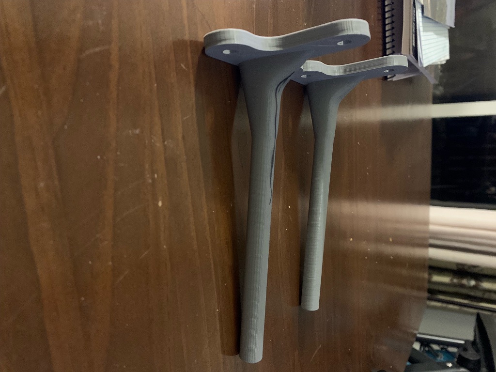

I've been researching and planning and making the necessary pieces for my delivery car. One item was the fender irons. I have drawn these unique fender irons up and 3D printed them to exact dimensions. I have now finally secured a foundry that will cast these for me. I was only going to have one set cast, but a forum member had contacted me and asked me about rear fender irons because he too is doing a delivery car, I told him where I was in the project. The foundry I'm working with is willing to do a small run. If anyone else would like a pair please contact me via email or call to discuss. The run is queued in December so I will need to know really soon if interested.

Mike, can you share info on what type of material is used in the castings? Fender irons are usually steel forgings, which can take some heat and bending. I once had some 1912 rear corner frame brackets made in cast steel. They were considerably more costly than comparable cast iron items

Note that your cast fender irons will not be the same size when you get them back as the ones you send to the foundry for casting.

Craig E. Luton wrote:
Wed Nov 17, 2021 12:00 am
Craig
Yes that's true if you don't adjust for shrinkage. I 3D printed several molds to adjust for the right shrinkage for the castings as per the foundry.
Thanks for your input and advice.

Allan wrote:
Tue Nov 16, 2021 11:55 pm
Allan,
The material that it is being casted in is ductile Iron which has a higher tensile strength and shock absorption to steel.
Yield strength- Ductile Iron- 40 ksi vs 36 ksi steel. There is a difference in cast iron and ductile iron as well. Cast iron has the potential to break when heated and bent and is a "cheaper" casting where ductile iron does not. Ductile iron is flexible as cast iron is not. I had to settle with ductile iron because to find a foundry near me that would cast these and do a small job was difficult enough. I know it's not "original" but these fender irons only hold the fender with support from the running boards. Not a whole lot of weight will be hanging on these.
Re: Delivery Car Fender Irons
Posted: Wed Nov 17, 2021 5:14 pm
by Allan
Thanks Mike. I thought there would be something different from cast iron.

I haven't worked with the tools for over 30 years, but as I remember, gray iron can be changed to white iron through the heat-treating process. You will have to inquire with a heat treater on that.
