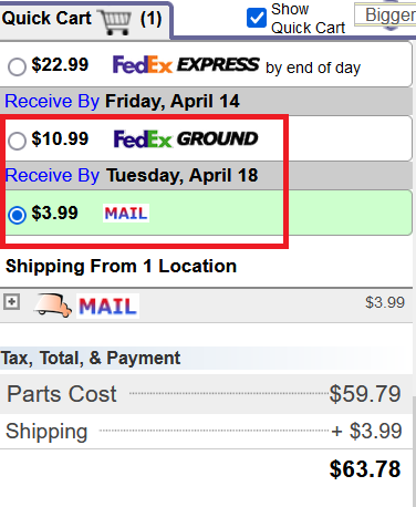

Why not just buy new from RockAuto?
Re: front wheel bearings
Posted: Wed Apr 12, 2023 12:56 am
by TRDxB2
Yes! RockAuto get the race too
Shipping FedEx Group same for 1 or 2 bearings. USMail went up to $5.99
eBay is $80 with free shipping +tax

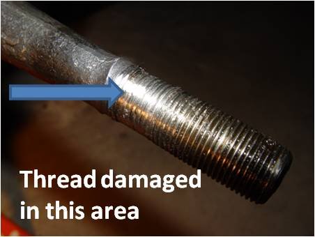

I have had Model A wheel bearing on all three of my cars. I drive them on tours every year and have never had a problem. They say it will hurt your spindles but after having them on all my cars for over twenty years the spindles look just like they did originally. Maybe I am in error using them but so far things are good.
Posted: Wed Apr 12, 2023 4:25 pm
by Scott_Conger
Larry, you are the fortunate exception. Unrestrained, and sitting on the crests of threads, unlocked from rotation in any way, they usually will put moderate to severe wear on the spindle threads upon which they sit. This completely ruins spindles, and is particularly tragic when it happens to early, rare parts. Getting away with something with good luck is, I hope, not an endorsement that it is good practice. If the spindle was ground round, for a solid and precision fit of the bearings, that would be an entirely different story. Hopefully, you will continue with your luck.
this is what usually happens when using Model A bearings in a "T":
Posted: Wed Apr 12, 2023 5:38 pm
by ModelT46
Thank you for the information about using slip on wheel bearings and possibly problems.. In the 1950s and 60s, it was known that Model A and early VB Ford front bearings would work and were used. They were not expensive and many of us had some NOS ones sitting around. I used them on at least some of the numerous Ts I have had. I did run into NOS correct ones, but I was not concerned about using the later ones. My 1910 uses ball bearings.
