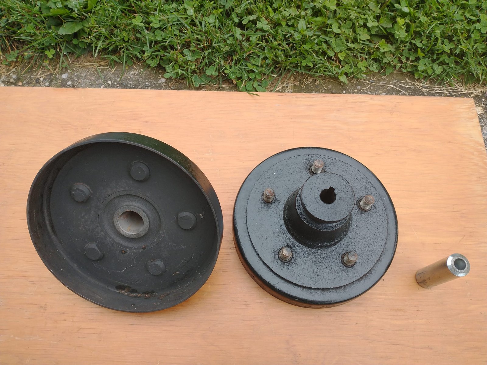

Here are the hubs I made up.
New studs and tool I purchased from Snyder's.
