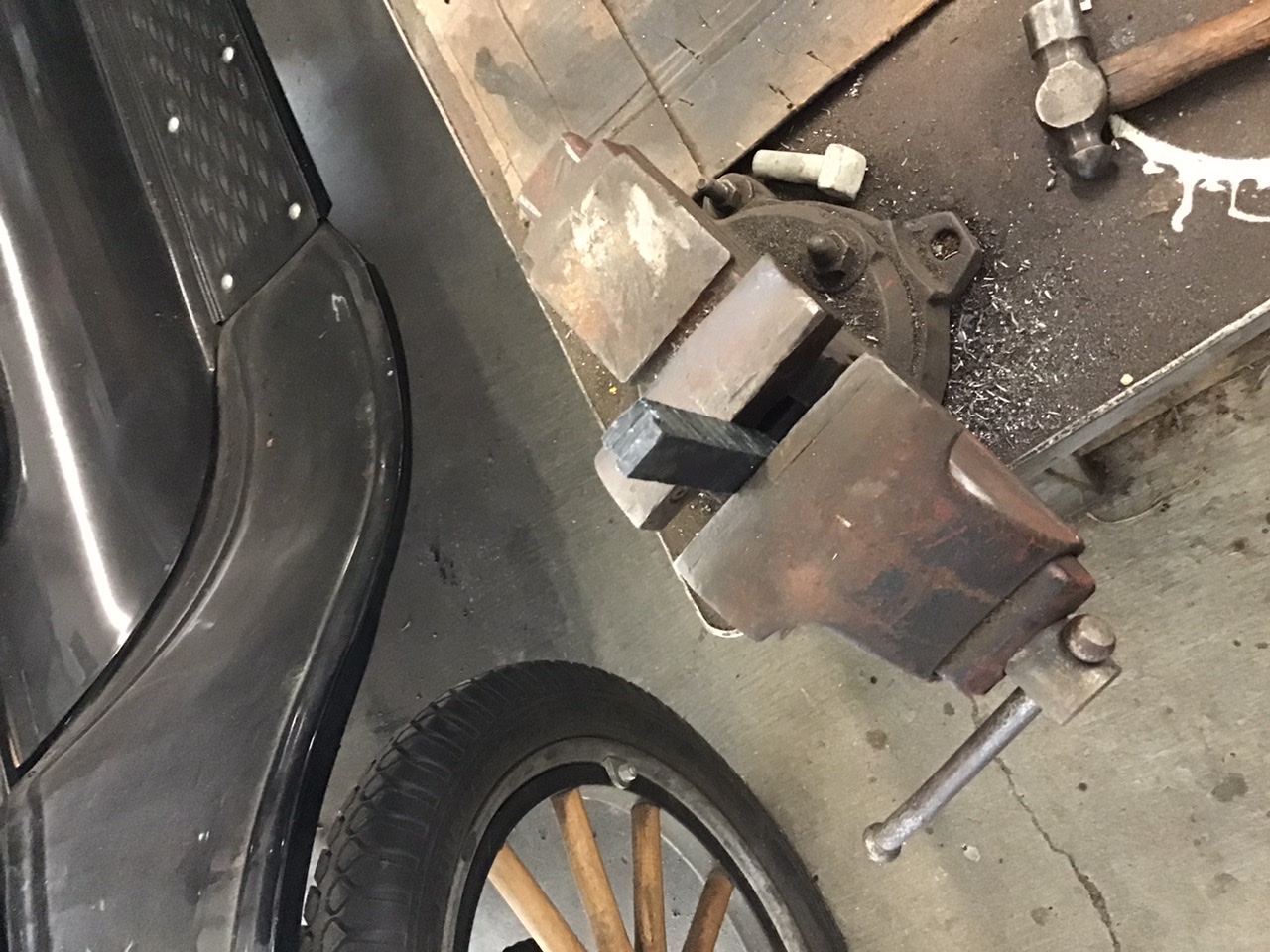

I used the Fordwood tack strips on my 21 Touring rebuild around 5 years ago. Went back to the shop in my left over wood parts box and had the cut off tack strips left overs. They were in a box in my garage that the temp. Range is from 30 to 120 degrees Fahrenheit. Texas weather. As you can see in the pic I put a piece in my vise and took several licks with a hammer. No breaking this stuff and not brittle. This is my experience with the Fordwood tack strip after 5 years.

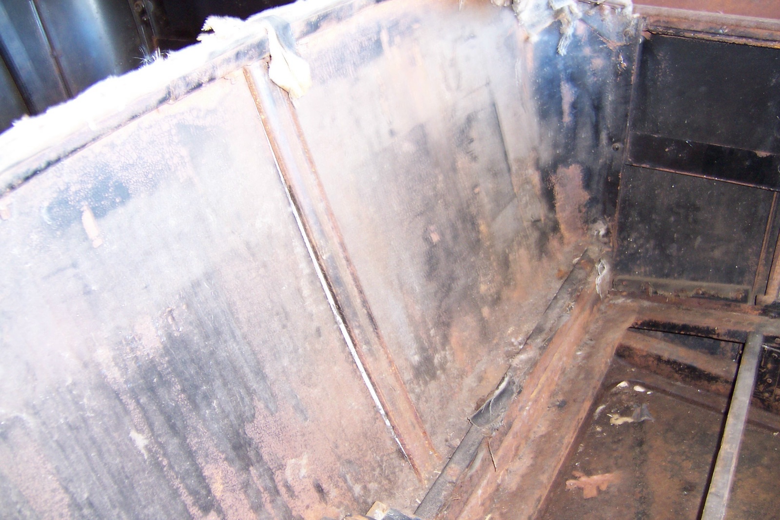

The front backrest on the Improved Touring takes the flex into account, Ford provided a steel channel upright with an angle iron piece to the wood tack strip to support. The front backrest didn't use wood uprights behind the backrest spring as the rear seat does.
Some restore without knowing this part is needed.
front stiffener forum.jpg (56.47 KiB) Viewed 5572 times

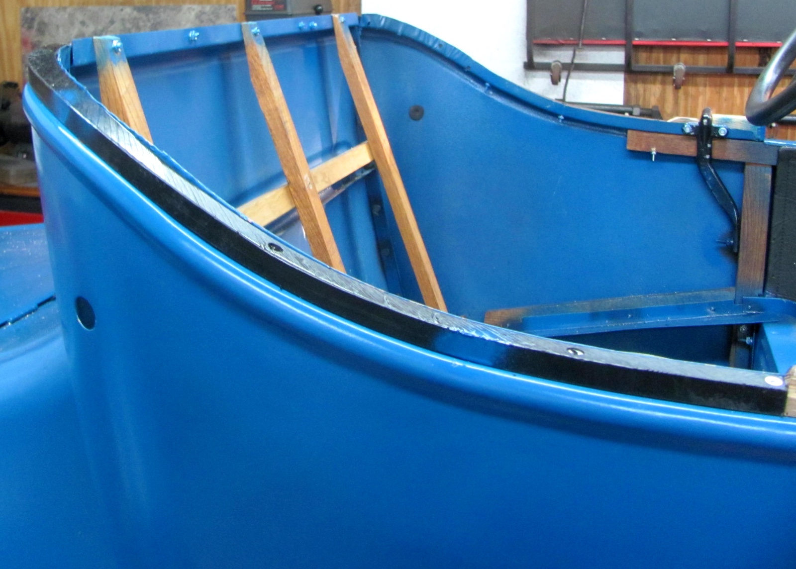

I've had the grandkids staying with me for a little over a month and I let this topic go into the bowels of the Forum. Here is the photo of a broken piece.
First, I have looked all over my shop for the rest of the broken pieces and I am concluding they are now in a landfill. What I did find is one half piece which displays a crack. The pieces cracked at the corner bend and at screw holes. This piece cracked where I had it lapped in the back of the seat. It is no longer bent to 90 degrees and has relaxed while sitting on the bench.
broken tack rail end.png (256.14 KiB) Viewed 5175 times
I am guessing some wil comment that by lapping the two pieces, I set up a stress riser. But it also cracked at the necessary screw holes as well as at the corner where it was bent with a heat gun.
As evidence of the thoroughness of my search for the pices, I asked my grandson with better eyes to help me search. He left no stone unturned.
not upright.png (359.65 KiB) Viewed 5175 times
