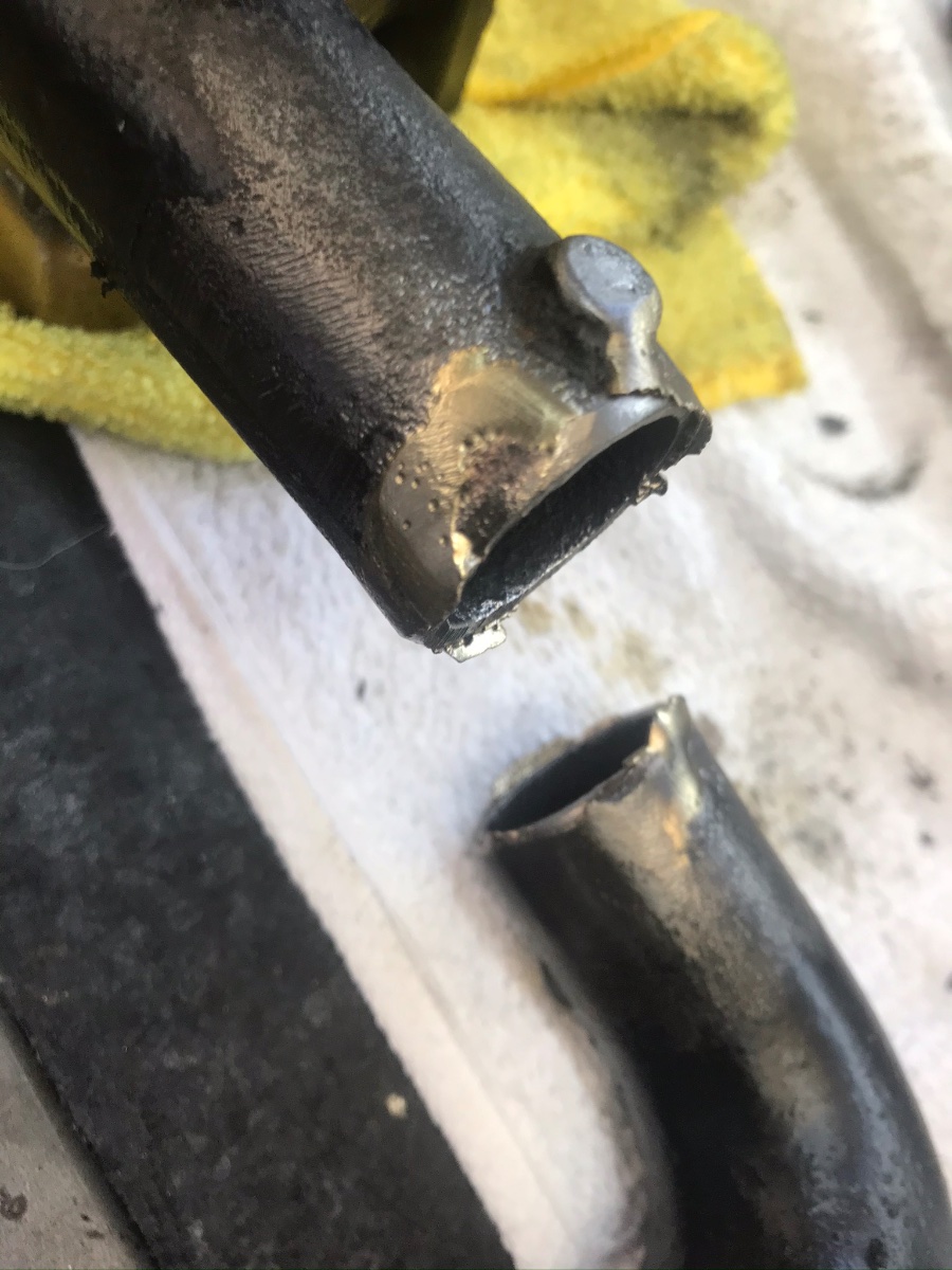

So a month ago "George" started running a little rough. At first I thought it was a spark problem as shorting #1 had zero effect. Hours down that path proved useless, so I just kept driving and Trying to adjust the mixture on the carb to no avail.
Then Last Tuesday I took a drive to get a flu shot and the motor started backfiring on decelerations. Richening the carb or advancing the spark had no effect. Ok, time to dive in, especially with an all-day tour coming up on Sat. What I found when I loosened the manifold bolt was kind of mind blowing...
Yes, that is my intake broken into two pieces. All of a sudden everything started making sense. No wonder it was running lean and backfiring. I'm sure it started as a hairline crack and got bigger and bigger as time went on.
Digging in deeper showed this cast iron intake was actually braised together long ago:
Investigating further I found the attachment flange on the updraft portion of the manifold was also braised onto the intake, clearly in an attempt to match the huge carb diameter to the manifold to increase the airflow. A noble endeavor by the previous owner for sure, and I know it makes a difference.
It took all my patience and creativity to braise it back together with silver solder brazing Rod, but I finally got it, and it ran great on the tour. And the air quality here in Sonoma County was finally tolerable!
I'm curious if anyone else has an updraft Winfield S or SR carb on their T and how theirs is configured. Pictures would be worth a thousand words.

Jeff: That failed brazed joint appears to me to have been made with a minimum of heat, all the brass is on the outer surface, none has flowed into the joint gap, making it a weak, fatigue prone mechanical joint. I suspect this was intentional to insure none of the brass seeped inside the manifold where it might disrupt air-fuel mixture inflow. At least the issue was easily identified, drive careful. jb
Good catch, yes, that's exactly what it looked like. I used silver braising rod this time (it was all brass originally) and made sure that at least 4 good sized places around the pipe flowed well into the joint. Better slightly reduced flow than breakage again.
