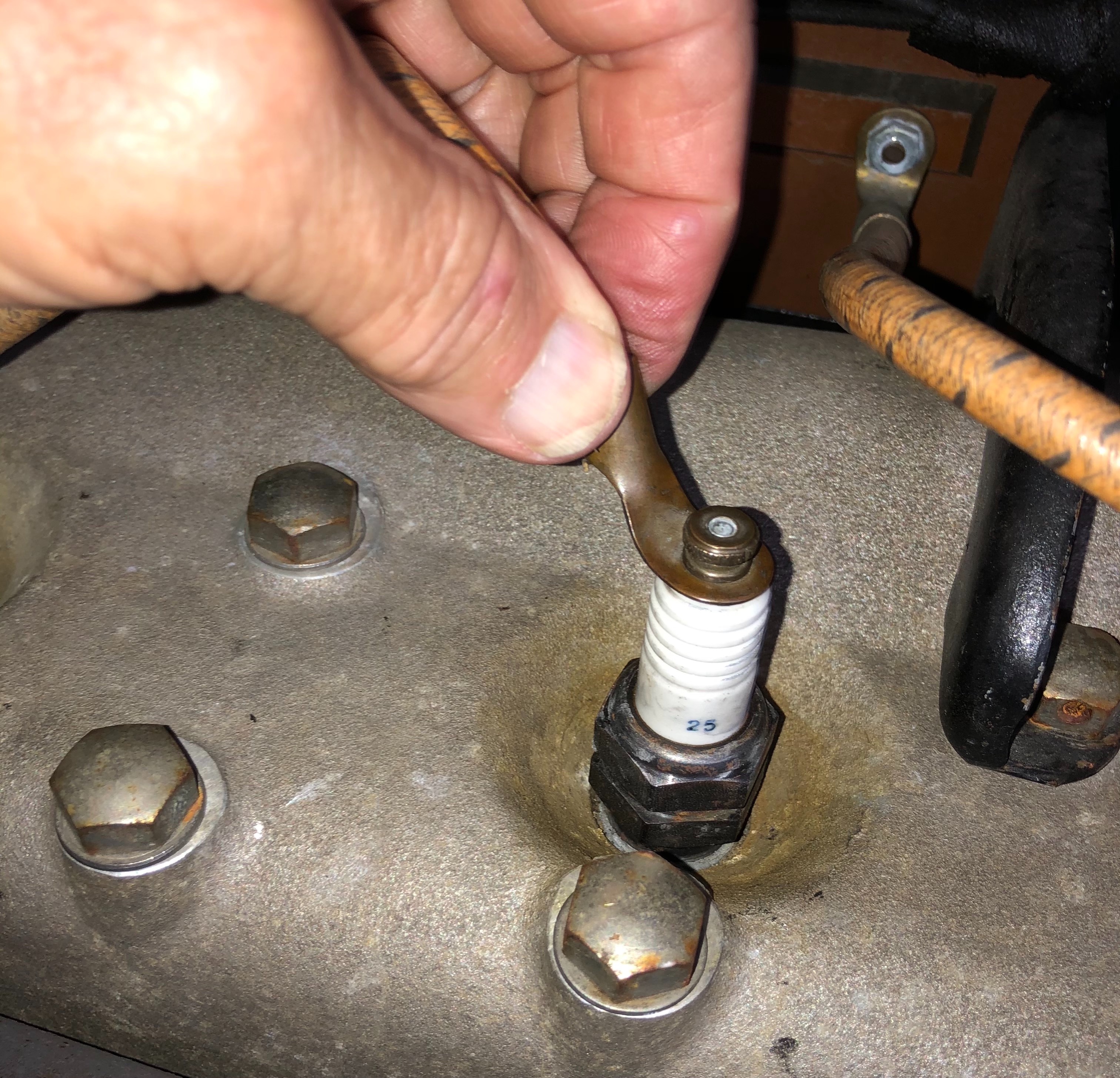

Have experience that before with the Champion 25, but still like this plug, run them fine. Seems to work well with the Prus high compression head, gapped at .025"-.028", hot spark from strong magneto too.
That upper post is only ceramic glued, so take care in plug wire attachment. Even Ford realized that use of pliers or tools on the terminal nut is bad for the electrode.
Tightening plug wire copy.jpg (35.6 KiB) Viewed 3209 times
So, I always do what Ford suggested, that is to twist the knurl nut with finger and thumb firmly on the brass terminal.
Then push on the spark plug wire to rotate the brass terminal on the wire clockwise, that will 'lock' the brass plug terminal under the knurl nut for solid contact.

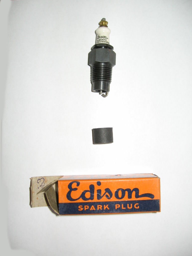

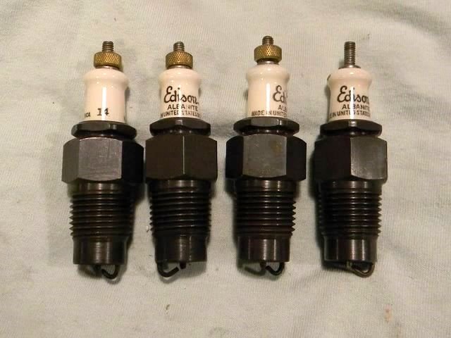

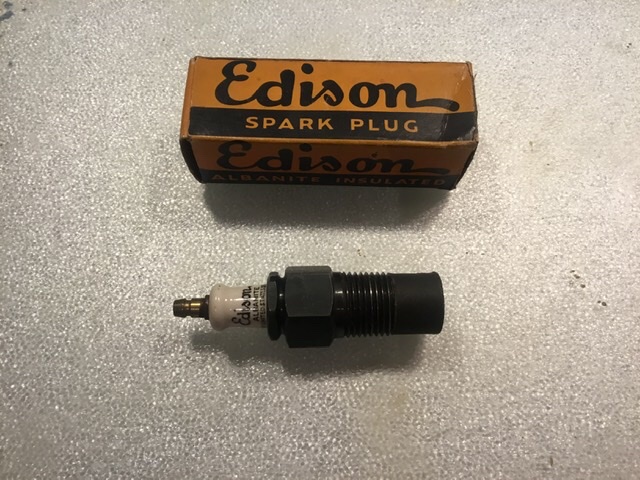

Has anyone used vintage #14 Edison’s? I have several mint condition ones in my display case, but use Champions I bought in 1970. Jim Patrick

I run Edison 14s in my car, they burn hot and run great. I haven't had to touch them since I installed them in 2014. :)
