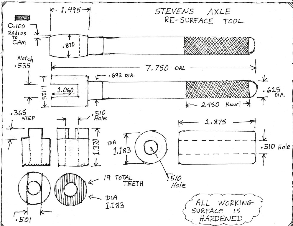

dobro1956
Posts: 1437
First Name: Donnie
Last Name: Brown
Location: Hills of Arkansas
Re: Used my rare Stevens Front Axle re-facer today
Post by dobro1956 » Fri Jan 08, 2021 10:46 pm
Allen, you are correct that it needs to totally clear the axle surface.
Here is a diagram I made of the tool. If I did not get all the info needed just ask here or send e-mail to the address posted and Ill try and get it for you ..
Post by Don D » Sat Jan 09, 2021 8:01 am
Donnie,
Thanks for sharing this topic. Your photos and drawing nail this down for those with a machine shop. If you hear of anyone who would be willing to produce these I'd be interested in purchasing one.
Have a great day,
Dom
Posts: 5599
Post by RajoRacer » Sat Jan 09, 2021 10:52 am
Thanks Donnie - great drawing !
Posts: 5599
Post by RajoRacer » Sat Jan 09, 2021 11:21 am
Allan - you can see in the photos Donnie posted that indeed the facer is a larger diameter than the axle yoke to properly machine the entire surface. A spindle body bushing is 1.0675 - the Stevens mill is 1.183 which is just over and 1/8" but less than 1/4".
