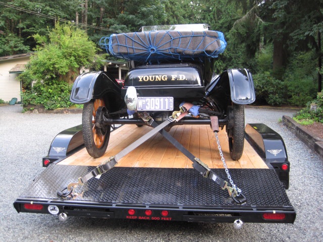

In 2001, hauled my 1926 coupe 1,400 miles from York, Maine to Central Florida on an open U-Haul trailer without incident. I hauled it facing frontwards. Of course you will need to tie down the car onto the trailer and remove anything that might blow off or out, such as the hood, the floor board and the seats, all of which can be hauled in the back seat or bed of your hauling vehicle. Unless you can adequately secure the removeable parts inside your Centerdoor T.
For such a long trip, I took the extra precaution of wrapping my T in several layers of 6 mil visqueen (sheet plastic) from a 20’ x 100’ roll and wrapped the visqueen covered T like a mummy over, under and around using 2 full rolls of duct tape. This was useful in keeping the visqueen from blowing away and the visqueen protected the T from wind, kicked up rocks, road debris and rain.
The U-haul trailer drove very well and though I drove it the recommended 45 mph for the first few miles, it wasn’t long before was keeping up with traffic going 70 mph on the interstate. As a matter of fact, it handled so well, it was easy to forget it was back there.
When you tie it down you will need to use four extra tie downs (web type ratchet tie downs at each wheel and crossing eachother) in addition to the wheel net type tie downs supplied by U-Haul but be careful when you tie it down. If you get it too tight, you can damage the front axle and rear differential. Best to attach tie downs to the leaf springs. And when you load it onto the trailer, it is safest to clamp an electric winch to the front of the trailer and winch the T onto the trailer. If you try and drive it on, you may end up driving it up onto the trailer, over the front rail and into the back of your hauling vehicle. To get the T going fast enough to get up the ramp, requires that, once on the trailer you bring it to a short, sudden stop and immediate stop, which the T is not good at doing. Make sure you have several wooden blocks the stack under the rear of the trailer so the rear of the trailer does not tilt down when you load the T on. Good luck. Jim Patrick
PS. Photos courtesy of onLine search

The Runabout photo above from the rear belonged to a friend of mine - I did a full chassis restoration on it years ago and THAT is the proper way to tie down in the rear ! I cross the front straps at the perches.

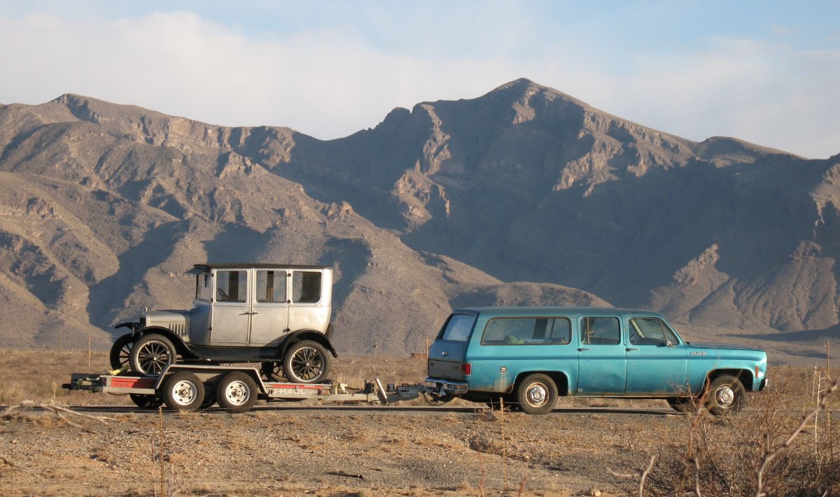

I rented a U-haul to bring this car home from the Phoenix area. It was fine except for the "wheel baskets", which would not stay on. Fortunately I had my own straps to keep the car in place. Caution: don't strap in the center of the axles, and don't pull forward on the front axle. I maintained a speed limit of 55 mph, as the Suburban is a voracious gas hog.
Every time I stopped, these were off.
