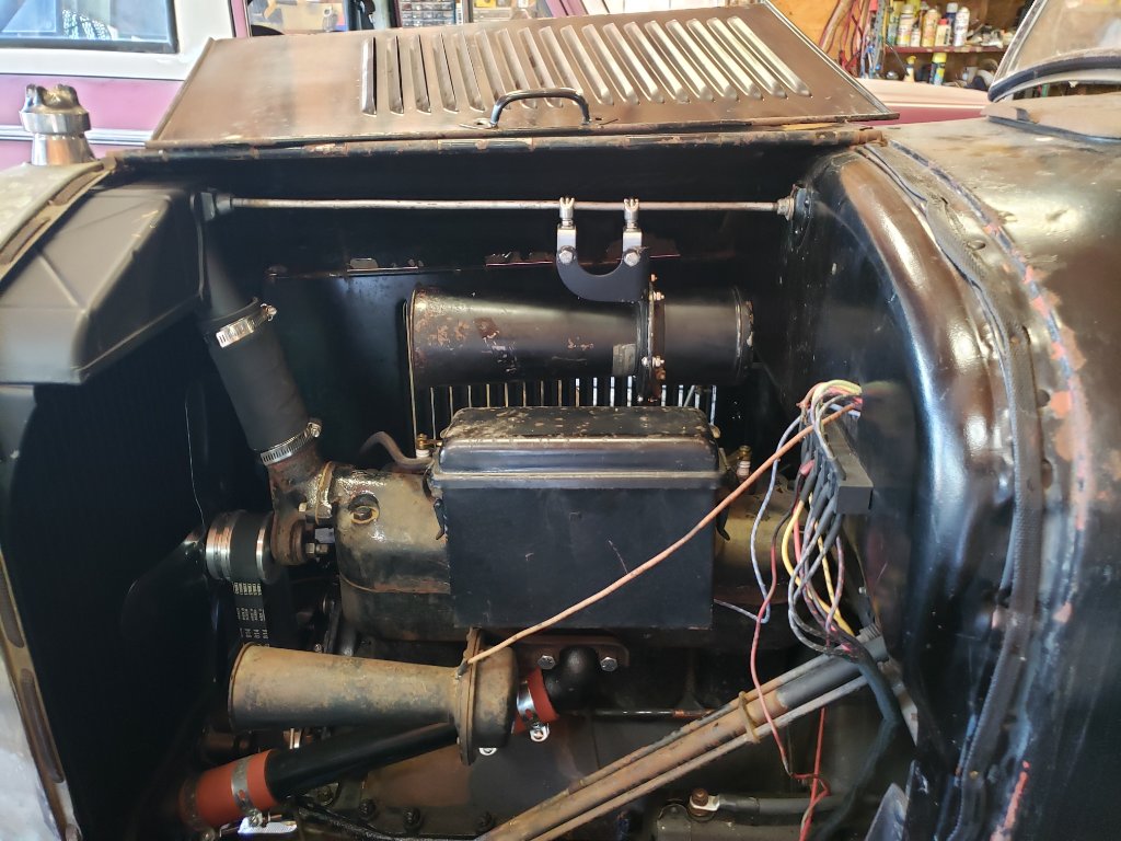

Here's how it looks right now. Getting too hot in the garage to do the wiring....sighhhh. Had to drill out the angle brackets to 1/4" The rope clamps are M8 5/16" All stainless steel.

Michael
now you need to send that picture to Berg's Radiator and ask them if they will warrant their product with that thing boinging around the way that it will. You may believe that your horn is mounted like Pat Kelley's, but it is not.
His due to the type of horn and it's relative location as mounted, weight distribution is far further aft than yours. Neither is ideal, but yours is going to be far more flexible and much harder on the radiator.

Couldn't that mounting bracket be rotated 180 degrees so the mounting point would be closer to the firewall? It seems weight distribution would be better too.

Keep an eye on those thin little L brackets. They are ripe to crack.

Are the L brackets necessary? The horn bracket could be mounted directly onto the cable clamp U bolts. This will shorten the mounting and enable the horn to be mounted more to the rear.

Hmmmm...lots of good thoughts. I put the bracket the way it is to try and balance the horn but it could be reversed if you guys think it would make that much of a difference. I did the L brackets so there would be less torque on the clamps and avoid the chance of the clamps slipping. Those L brackets are a little thicker than the stock bracket so I figured they would be fine...3mm thick stainless. Again, I could mount without the L brackets, though....it would give less a lever arm as well.

I have been following this thread with interest. The magneto horn on my 17 T works well, but only within a limited rev range. I have an A model horn I an add, and the cable clamps idea is about as neat I have ever seen. If they are left loose, the horn can hang as it wants, and if tightened up at that point, it would seem the best solution.

I was able to flip the bracket but I couldn't eliminate the L brackets due to the offset of the original bracket. That offset pushed the horn into the coil box so I had to raise the horn up to provide clearance. Also had to give it a bit of a rotation from the vertical. What do you think? Better?
