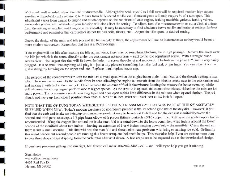

Years ago, Stan sent me a booklet that included a reprint of the original period Stromberg literature. The booklet also contained four pages of original material from Stan based on his extensive experience with this carb. Here is a copy of the original Stromberg literature from Jay Klehfoth, along with scans of the four additional pages added by Stan. Hope these help.

Here are the four pages rotated and enlarged. You sacrifice a little sharpness when you blow them up, but they're still readable.

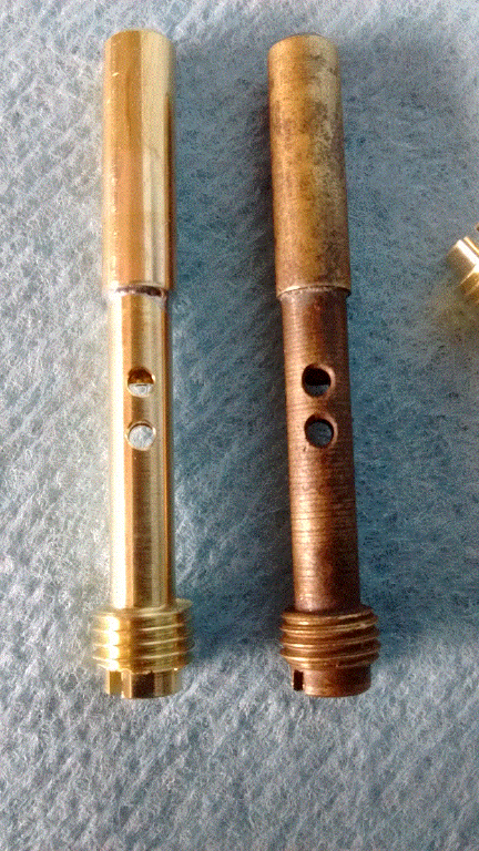

No one making specialized parts for them?
Do you mean specialized parts like these?:
Last edited by Scott_Conger on Fri Aug 06, 2021 10:35 am, edited 2 times in total.

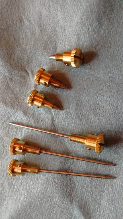

- Posts: 6799
Re: I'm No Stan Howe
or these?:

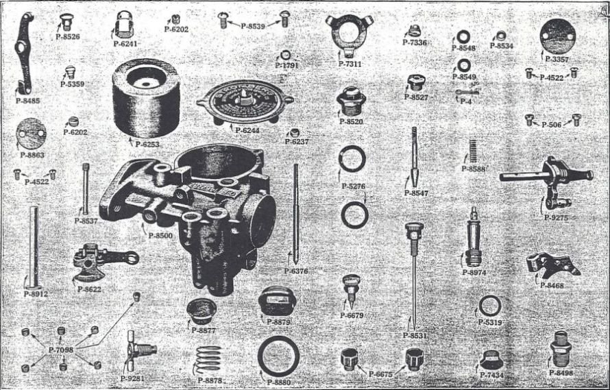

A few pages from an OF pamphlet which, as I understand it, was supplied with a new carburetor.
Golly, it is a real inconvenience to be limited to only five images when, in this instance, there are more pages of the pamphlet to be shared. Bill
More to come.

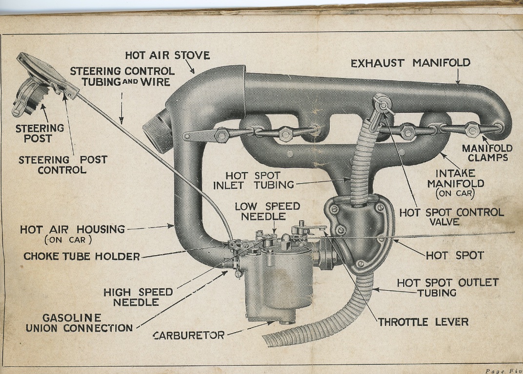

Here are the next pages:
Another batch to be posted. "Watch this space."

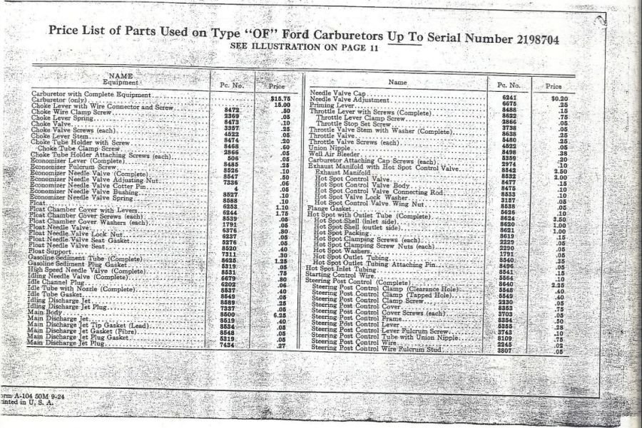

And here is the last of it.
Two advertisements from the period:
