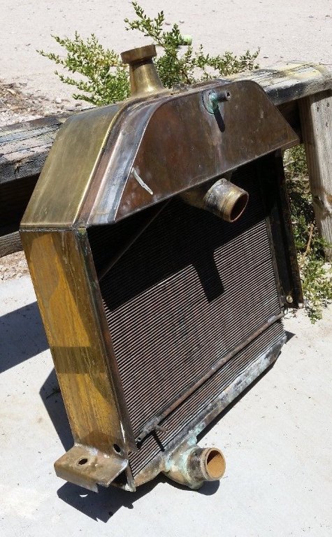

Hi,
I've just received the "plumbing kit" for gas headlights and wonder how the pipes ran around the radiator.
Apparently a pipe is going from the splash apron at the gasgenerator along the fram in drivers/left side (if generator sits on the running board there which I believe it did most often with Lhd).
The pipe ends in a T joint that are soldered to the pipe. Then two shorter pipes are solded to the T joint as well and these pipes ends just inside the radiator shell where the rubber hose are connected between the pipe and the headligt. Same applies at the generator.
Can some kind soul evebtually share a picture of the placement of the pipe and the T joint etc beghind the radiator?
Thank you!

Michael-
For 1913 and 1914, there is a cross-over pipe with a T that should be attached to the radiator. It is then mostly straight pipes and rubber hoses.
http://www.mtfca.com/discus/messages/70 ... 1509461871
viewtopic.php?t=14709
https://mtfca.com/phpBB3/viewtopic.php?t=2012
I hope some of this helps.
Keith
Keith

Re: Headlight plumbing
It sure is, but the shown radiator the length for the two sides are unequal, which may give different performance of the two sides (a note that followed the kit claims).
It is for a 1914 Touring. I'll have to go to the winterstorage and check if that pipe already sits on my radiator.

I just did this on both my '13s within the last two years. It was a fun project. I never did a double flare until I did this. You need a special tool to do it.
I was able to use a brass T, and I bought the tubing from McMaster Carr. The tubing is soldered to the radiator as pictured above. Pay attention to the hole you must put in the splash shield. This is important. I drilled a 1/4" hole, and drilled a correct size hole in a block of wood, and placed it on my floor jack to support it, and used a taper punch to increase the diameter of the hole to the proper size to support the tube.

Keith,
Thanks for posting the above detail. Just noticed the drawing had a note added (in the lower left corner)
when the crossover pipe was used in production:
"1912 > after 75,000 cars - 1913 - 1914"
Suggests the radiator side plates punched for gas hoses and above crossover soldered in place, the 44" rear gas line
and clamp, left splash shield punched for the gas hose and running board punched for the carbide generator
were being used after about 132,000+/-, June 1912 or so. Three or four months before the 1913 models appeared.
Makes the acetylene plumbing on a later 1912 much easier.
