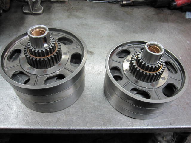

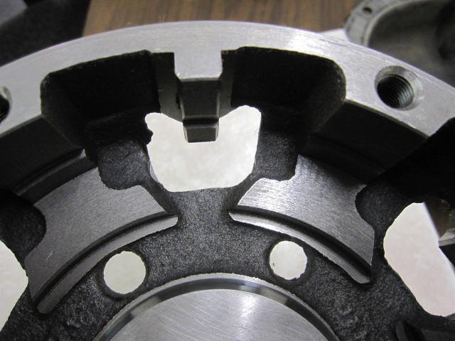

Make sure they can clean and crack inspect them first. !
The picture enclosed is the reason we started making new drums and hubs as what was is available wasn't to our standard nor to Ford's.

What J&M said. Many original drums have cracks, often hard to see. Reverse drums especially seem to be problematic, but lots of the others are cracked too. That's why my busted low drum will be replaced by a new one from Dave Nolting.

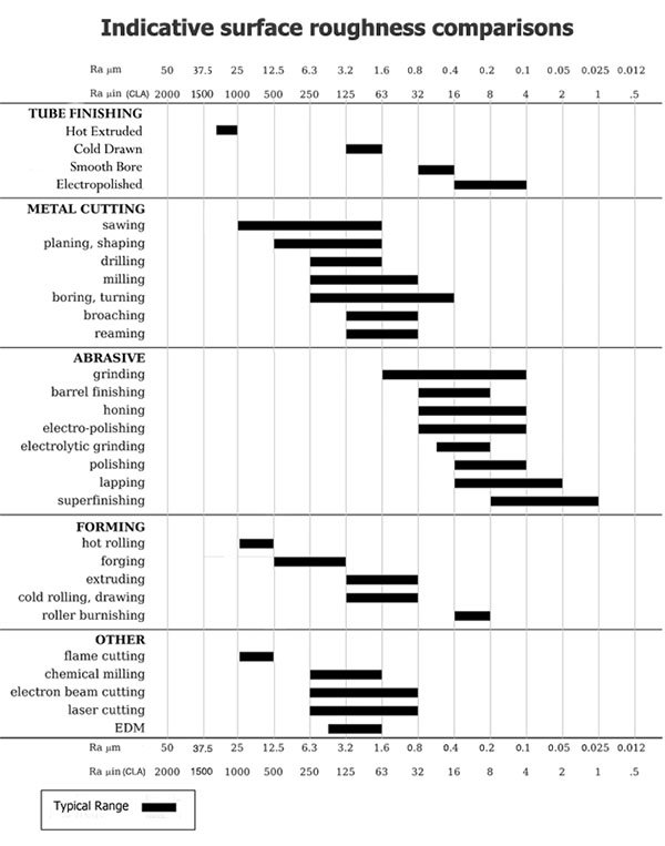

Is there a surface finish (micro finish) recommendation (Ford drawing) for the drums? Could it be different for softer bands (cotton) versus harder Kevlar?
Posts: 6831
Re: Machine shop (lathe) Oregon
Post by Scott_Conger » Wed Dec 15, 2021 12:16 pm
Someone will have a drawing, and I'll bet there is no surface finish call out that equates to modern measurement systems (if any at all). In reality, a 32Ra or 16Ra finish is fine. 16 being a bit of overkill.
With the correct tool and surface speed, lathe turning is absolutely fine if you know what finish you are seeking. If you just whale away at it with the wrong tool or speed, you'll end up with a decent looking finish which will be murder on the linings. Grinding is a little more fool-proof, but not mandatory. Turning them is what I do on the rare occasions I feel I must, and I've never had a problem.

There is an overlap in the Ra finish possible for either lathe turning and grinding. 32-16 is possible with lathe turning. Easier to find someone who can turn your drums rather than grinding.
