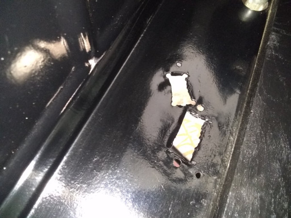

			 Working on correcting a few things on my '20 Roadster that have bugged me for some time.
These two cutouts appear near the starter button on the floor.  I have no idea what a previous owner was attempting to do or had rigged up.
Short of tearing the entire seat assembly apart, how could I repair this?  It's covered up by the floor mat, but still I know it's there.
Any insight much appreciated  !

			Probably the remnants of one of a billion accessories available. Could just patch it with some rivets.

			JB weld in some patches. I went through a long litany same time as the "other Tim" and mine got tossed out. This is the short version!

			You could cut the holes a bit bigger to allow use of an additional brake. Just be sure you wear thick heels.

			How do I fix this, really depends on what tools you have, and your skill level. The BEST way is to replace the panel. Next best would be to hammer &  dolly the area flat. Then trim the openings for repair patches to be butt welded into place. Then metal finish. Third & worst, glue or pop rivet a patch over the area. Darryl

			I would get a good flat piece of sheet metal and pop rivet it over the two holes.  Paint it black first and after its pop riveted in touch up the pop rivets with a dab of black paint.  That’s the easiest way to do it.
The best way is to replace with a new panel.   If your car is a good looking driver and not intended to be a show car patch up the panel in some way that looks decent.

			Why were they made ? Muffler cut-out pedal is one possibility. Scars from a long and useful life.

			Install a cut out, Kick pedal, Bob
