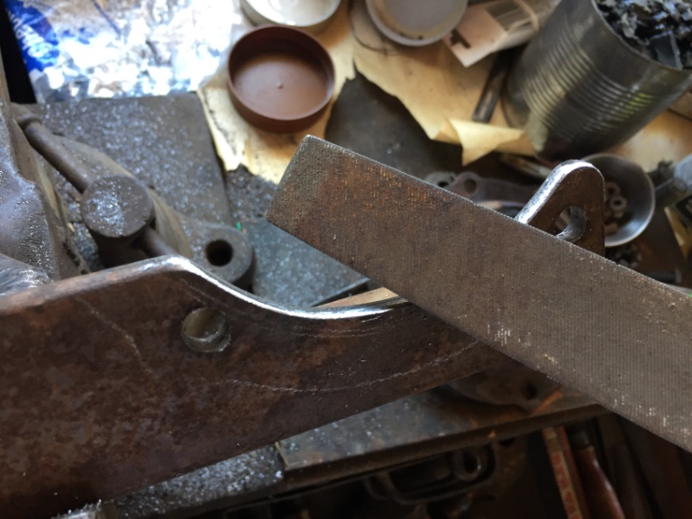

Course filing:
Fine filing:

Finished Bracket.
All hack saw and file plus a weld.
