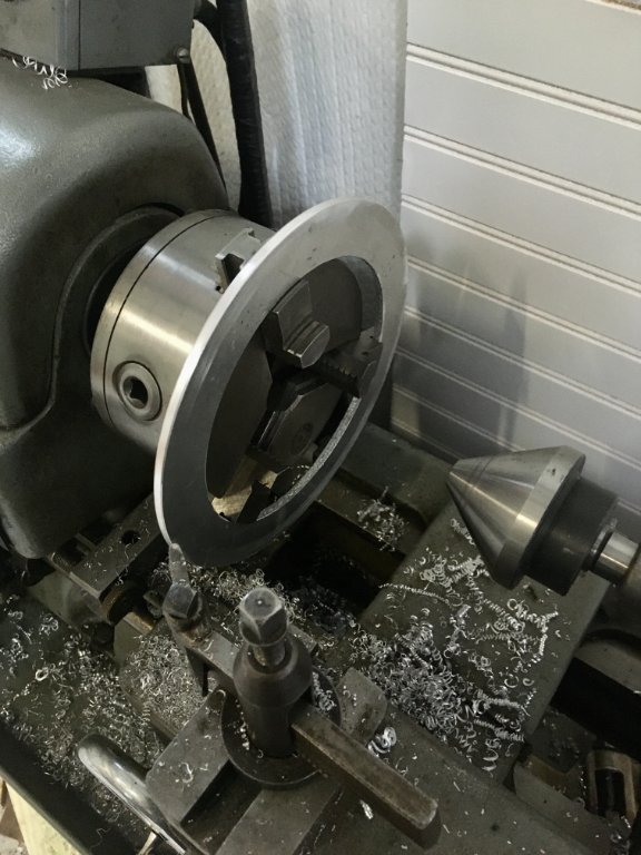

I tried my hand at building a Triple gear pin locking ring.
first I cut a piece of 3/16ths aluminum plate. then turned the inner and outer dia in the turn table on the Bridgeport then turned the outer dia to size on the Atlas lathe then turned the inner dia on the Clausing lathe then test fit to the flywheel“Whether you think you can, or think you can’t-you’re right.”

Very nice work. If the triple gears are loose enough to push one way, they could also go the other way too. The magnets don't hold them in, the press fit does. The part that presses into the flywheel is not tapered. https://www.mtfca.com/discus/messages/4 ... 1409111125

The majority of original triple gear pins have a small shoulder at the end of the press fit diameter. This shoulder and the magnet contacting the end of the pin is intended to retain the pin in the flywheel along with the press fit. Most aftermarket pins I've seen do not have this shoulder. Just FYI.

So Dan, In your opinion, does this type retaining ring serve a functional purpose?Dan McEachern wrote: ↑Thu Jul 06, 2023 2:20 pmThe majority of original triple gear pins have a small shoulder at the end of the press fit diameter. This shoulder and the magnet contacting the end of the pin is intended to retain the pin in the flywheel along with the press fit. Most aftermarket pins I've seen do not have this shoulder. Just FYI.

My thought is, if the pin has come loose to the point of needing a retaining ring, you're in deep doo-doo anyway. Do pins ever come loose even when magnets are used? I think they do sometimes...

I have installed Dans pins in the flywheel and needle bearings in the triple gears. this type cannot go thru the flywheel. this is why I had to turn a step in the ring because the pin set up a little bit.

Read this thread will answer the question what Dan M. thinks.
I have never seen a pin come loose but I have heard of it. That is why when I remove magnets for a customer it gets one of Dan’s rings.

You really WANT the ring to push on the end of the pins and not be flush with the flywheel. At least that's my opinion.
John- I suppose its a belt and suspenders kind of thing, but I think they are cheap insurance. Nothing is going to stop a seized bushing from tearing the pin out of the flywheel, but that's a whole separate can of worms................................. I just think that Ford intended the magnets to push on the end of the pin, so the plate kinda does the same thing. I've tried other methods, but the 16 magnet bolts VS the 3 pins and the "no good spacing" issues with that made the ring the simplest solution for me. I've been told the latest revision to the triple gear pin drawing removed the shoulder in '26 ? as probably a cost saving effort, but I prefer that the pin has that step. It only adds one additional operation when grinding the pins so...............in the big picture, its not a big deal.

I believe the Thread Dan Hatch posted is the one that I read that made me want to build one.
I had a lot of fun though and I probably have 4 hours in it.

I had to tap it on with a hammer, so all was good on the pins and the flywheel. fit nicely.Dan McEachern wrote: ↑Thu Jul 06, 2023 4:24 pmYou really WANT the ring to push on the end of the pins and not be flush with the flywheel. At least that's my opinion.

Bryant- make sure to have that flywheel balanced before assembling the transmission.

Thank you I will. I’ve also built some oil slingers but I will let them loose in another thread another time. Iam currently building balancing mandrels for the flywheel and trans drums. Just checking off boxes in the MTFCA transmission book!Dan McEachern wrote: ↑Thu Jul 06, 2023 4:43 pmBryant- make sure to have that flywheel balanced before assembling the transmission.

Bryant, were you saying that the triple gear pins were slightly proud of the flange on the back of the flywheel? As to say that the ring (or magnets if installed) would be slightly elevated above the flywheel flange? If so, did you measure the gap? I am just curious because mine did the same thing, but it bothers me that the pins were not flush with the flywheel.

I don’t recall what I took off but it wasn’t very much. I’ve got the flywheel assembled to the engine for test purposes at the moment so I can’t get a measurement now. Again the pins I used were Dan’s. They are designed to be used with caged needle bearings. He may be able to tell you the measurements though.1923Touring wrote: ↑Thu Jul 06, 2023 6:57 pmBryant, were you saying that the triple gear pins were slightly proud of the flange on the back of the flywheel? As to say that the ring (or magnets if installed) would be slightly elevated above the flywheel flange? If so, did you measure the gap? I am just curious because mine did the same thing, but it bothers me that the pins were not flush with the flywheel.

Look at drawing in the link I posted. Pins are made to do that. That keeps them from coming out the other side of flywheel. Magnets stop them from coming out the magnet side. His ring acts like the magnets. Again, I have not seen a pin move, but have heard of it. Cheap insurance.
Dan’s pin are only ones made to Ford drawing. Also only one with correct finish on the bushing area too. Run your nail up and down the cheap pin. Feels like a washboard, what does that do to your bushing?

What made you decide to not run any magnets?

I’ve acquired a Bosch front plate and distributor. Some was fear of the unknown (magnets breaking and flying apart) maybe unlikely but I read a thread on here about it
