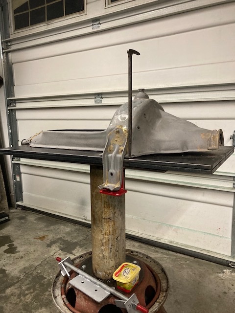

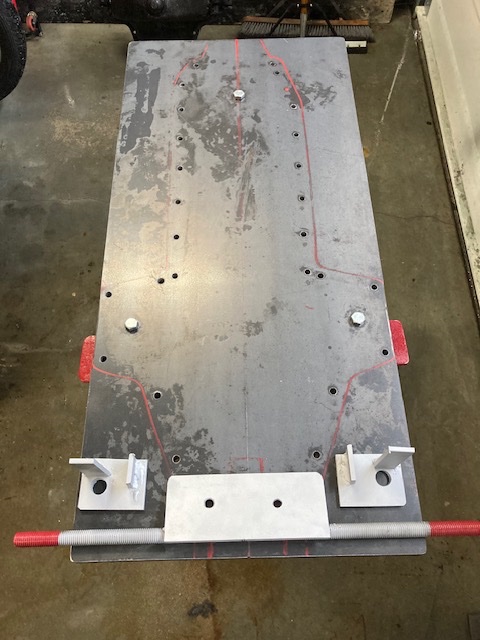

Re: pan straightening/support question
I built my own pan jig for less than $500, works fantastic, I drilled every hole, so I can bolt easily in place, tap all around with a hammer and leave sit in place overnight.
Regards,
- Posts: 5269
Very nice.
How thick is the plate?
Approximate weight?
Approximate weight?
havnfun
- Posts: 479
- First Name: Joe
- Last Name: Kowalczyk
- Location: Kuna, Idaho
The plate is two 1/2 inch thick plates bolted together, Heavy very heavy, I use a mini skidster to move it, or disassemble and move. Each plate is heavy around 100lbs my guess and base is another couple hundred lbs.

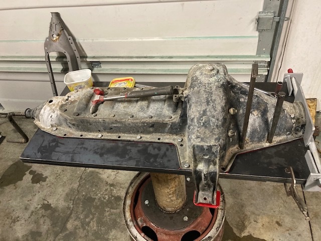

Here are couple pictures of straightening
Regards,
havnfun
- Posts: 479
- First Name: Joe
Here is a 1913 pan being straightened
