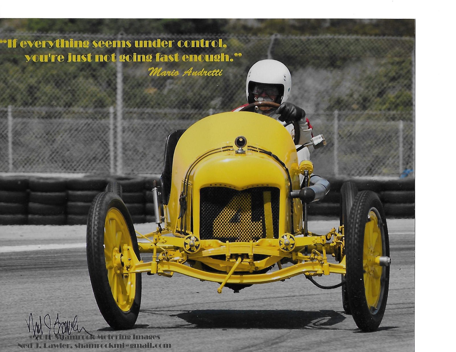

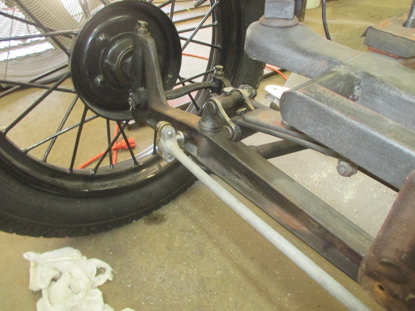

Re: Panhard Bars on a Model T
Thank you guys for forcing me to sort through some old photographs/memories, to find a decent shot of the Panhard bar on old #4. Simple but functionable. I know no one needs another shot of old #4 but take a look of the Panhard bar/steady steering device. Bolted to the left of center, on the front cross member and stretching across to the right and attached to the upper bolt of the spring shackle/perch. It's made of approx.1/8"x 1" flat iron with a second layer riveted to it. The second layer stretches almost all the way to the bolts on each end. So simple and I've never had a car that handles as good. The first picture was a gift to me from professional race photographer Ned Lawler, taken at Laguna Seca Raceway in Monterey during a race, as I was exiting a sharp left, turn 11, at speed. The other picture looks down at at the bar with the radiator removed and shows it bolted to that front cross member. There may be better ones out the but this simple set up sure works great and I doubt if many of you are going to stress your car much more than I do.
Ed aka #4
