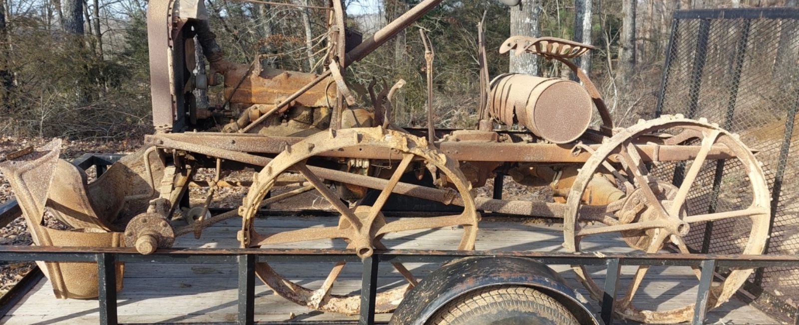

I've posted some pictures in the photo section under James, assuming I did it right. Would love someone to take a look and help me identify this thing. Serial number is so rusted I haven't been able to read it. I believe it's a mid 20's T with the truck conversion. But then there's an extra transmission, and I don't know what that even is. Really trying to find out what wheels and tires I need. It has the Ruckstell rear-end with large axles. Ignore the rear wheels as they are off an International pull type sickle mower.
New to all this, so if there is a better way let me know.

Looked at your Gallery ad of 5 photos, found under title Made It Home.
Your T chassis is a mid-1920s, the engine is a 26-27, has wide pedals, cyl head mount water outlet fan, the rear axle is from a TT truck, worm drive with accessory Ruckstell added.
That ton truck axle is hard mounted to a T frame, so it has that spring solo seat to manage the bumps.
In addition the shortened drive line has added transmission, not sure of mfg. , but likely a Warford.
A set of tractor wheels would allow this set up to really pull in the low gears of that custom drive line. A typical TT truck is fitted with wood spoke hard rubber or pneumatic tires on split rims.
I added these close ups of 2 photos.

Thanks so much! I was beginning to think this was some weird collection of various parts, so that's good to know. Those steel wheels were just slapped on there so we could get it out of the shed it was in. Any ideas on what kind of wheels I should be on the lookout for? Found someone on Ebay that has a pair of 20-inch rears. Not sure what would match on the front though.

Confusion comes with the words "the truck conversion". Ford started selling pickup trucks in the 1925 model year. Before that they sold you a chassis (car or truck) and it was up to you to build or buy a body for it. Ford did not sell a conversion kit. There were several companies that made aftermarket TT bodies, but pickups were most often home-made from a car.
I looked through the picture gallery and saw no post from James, so maybe you should put your pictures here in the same post with your question.
Sorting out the years of various parts can be a major research project, and there are some references that can help. Obviously parts books cover some questions, and the encyclopedia has much to offer. https://dauntlessgeezer.com/DG80.html

Depends on your plans for that homemade tractor of T and TT parts.
Original TT would have std for the years T car front wheels. Typical today easy to find front wood spoke 23” dia, with demountable rims using 30” x 3 1/2 “ clincher tires. The front wheel T hubs are easy fit to your axle spindles.
So finding pair fronts in good condition rather easy as lots of T’s around.
TT rear are larger axle hub taper, with spoke wheels in 20” or 32” dia. , (correct me if wrong,) but later TT used larger balloon tires, on demountable split rims.
Finding good TT rear wheels in good wood condition is much harder, and rims are rather pricey in nice shape, not to mention larger tires cost more.

James,… the easiest is to acquire a TT frame and rear springs. They’re fairly inexpensive and your ride will be much more enjoyable.You’re in Mississippi - there’s a lot of T and TT people there with parts. Yes, rear wheels, rims and tires are expensive. Your front hubs and rear hubs are different. I have lots of TT hubs, flanges, powder coated felloes and emergency brake drums I’d sell but then you’d need to have them respoked. Correction from above: TT rear felloes are either 20” or 23”.

Trans is definitely not a Warford. Probably adapted from some other car make.

Its a garden tractor. Car chassis with a TT axle for lower gearing.
The extra transmission for additional lower gearing. It needs iron tractor wheels similar to what you have shown.
Putting T wheels to turn into a TT truck? Its way cooler as a garden tractor.

We were wondering that! Guy that my friend got it from didn't know much of the history. We couldn't really figure out how they pulled anything with it. It will have a lot of reduction with another 3 speed though. He wants to weld the sickle bar wheels to some hubs and use those. I'm not really convinced, but this is a beater project anyway. I'll feel a lot better once it's running.speedytinc wrote: ↑Sat Aug 16, 2025 12:20 pmIts a garden tractor. Car chassis with a TT axle for lower gearing.
