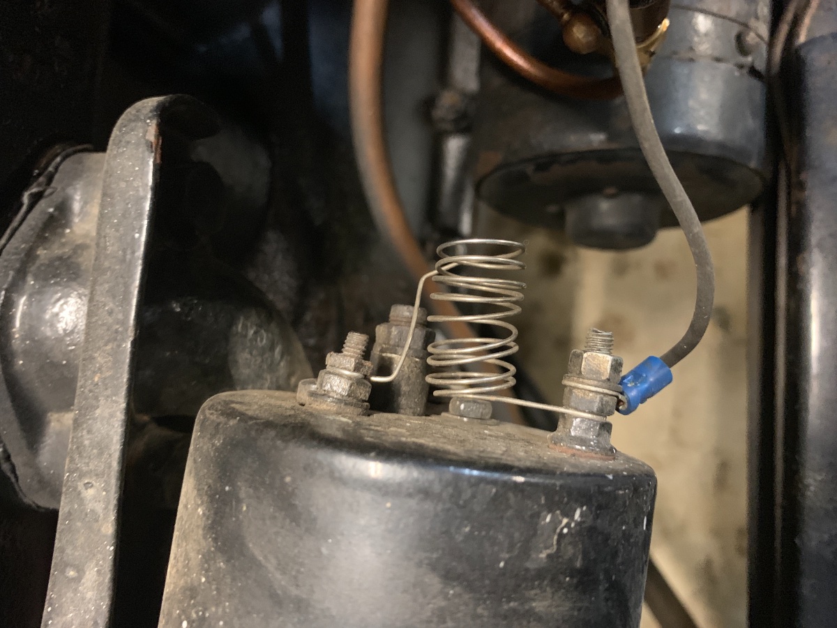

Matt in California
- Posts: 786
- First Name: Matt
- Last Name: G
- * REQUIRED* Type and Year of Model Ts owned: 1926 Touring, 1926 Fordor Project, TT C-cab flatbed farm field find, TT dump truck project
- Location: California
Re: reducing 12v to 6v
I have used wire like Hank above. I have also used a resistor (see picture). Depending on the current draw resistance values may need to be changed. A voltage divider with equal value resistors would be problematic for something drawing a lot of current. If the Horn drives around 1 Amp at 6 volts, a one ohm series resistor will drop 6 volts. I had a .6 ohm resistor handy it dropped about 4 V leaving 8 V on the horn.
Matt
