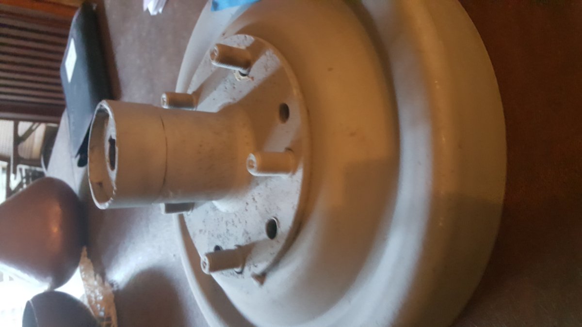

I understand why someone would use an earlier rear hub and re-drill for five studs to fit a 26-27 brake hub, but I don't understand why a ring was tack welded to the threaded area of the hub. I'd appreciate any observations or comments on this modification. It certainly makes for a difficult removal.

They should have added a ring to the outside of the flange area to properly support the wheel against the bolts. A wire wheel hub is bigger in diameter at the flange

The hub is off something else.

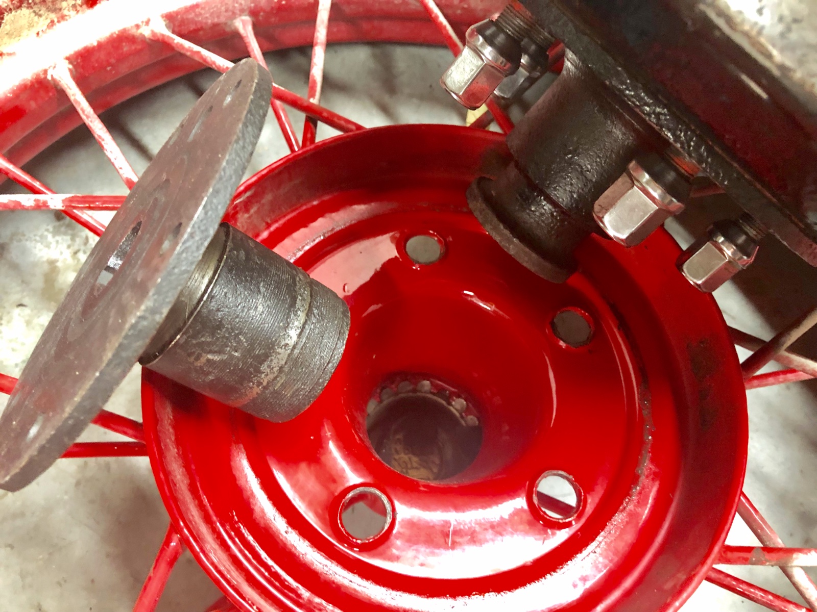

As Les posted, at least he put the sleeve over to increase the diameter of the hub to help secure it to a wire wheel. The T wire wheel has a tapered snout to provide lateral thrust when rounding corners. The front and rear T wire wheel hubs mate with the T wire wheel snout in that manner. 'Bout the only way to pull that modified rear hub now is with a knock off.
Note how much smaller the wood rear hub is compared to the T wire wheel rear hub.
And inside view of the wood rear hub, and wire wheel rear hub, and the cone-shaped snout of the T wire wheel. Where the cone necks at its isthmus is where contact is made to the ring on the Ford wire wheel hub, provides the proper contact to keep strains off the lugs, when outboard loads are applied like cornering fast.

Thanks for the information. So it looks as though I have two problems. First, the diameter of the flange, being smaller than a 26-27 hub, may not support the lugs. Second there is nothing to grab with a puller to remove the hubs from the axle. This explains why the axle nuts were not snugged down when I removed them. I'll install them to finish the restoration and have four wheels under the car and be on the lookout for a pair of good 26-27 hubs. Great information!
