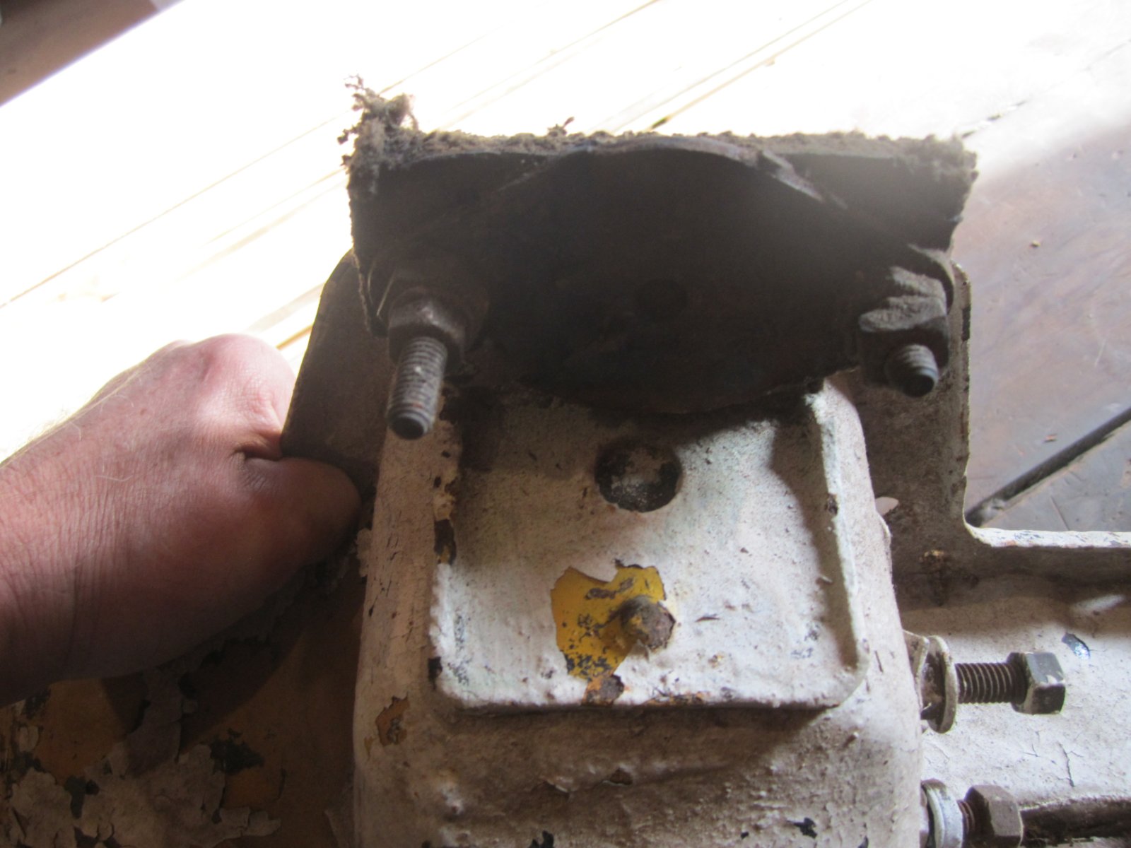

Here are some pictures of what I have done
1. Stretch of pan
2.relocation of front mount
3. Oil pump mount and block “stretcher”
4 SPEEDI SLEEVE for key cover
5 sleeve installed
1. Stretch of pan
5 sleeve installed

Re: Model T engine with Model B Crank
Thanks Les, some more pictures. The block is moved forward on the pan. The spacer on the end of the crankshaft I believe is when he ran this engine with the aluminum crankcase and C-4 transmission.
