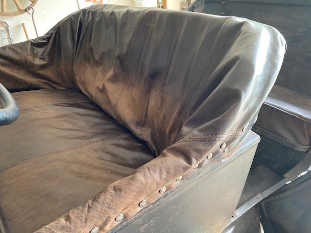

Re: 24 Touring Barn Car Revival - Part 3
Another big step forward today. I started in on the interior.
I recently found these free leather couches online and cut away the first section for the front, bottom seat covering. I made a perimeter out of 1/4 inch plywood and wired it to the spring. Then I attached the leather to the wood with a staple gun.
1924 Touring
- Posts: 2789
- First Name: Dallas
- Last Name: Landers
- Location: N.E. Indiana
- MTFCA Number: 49995
Don, I cant help but think about the leather on the couch. Oh no butcherd again!
Looks good and I bet its soft to. Has a nice worn look to it.

More upholstery work on the T....using the old leather couch that I scrounged, for the material.
I ripped the factory couch seams in a place that I thought would sort of match the contours of the front seat bucket and then draped it over the area. It's just loosely laying there and there's a lot of adjustment to be made but I'm pleased with how this first attempt at making it fit looks.
The springs/stuffing have yet to be installed. I may have to untack it partially to get that done, but that should be easy to do.

Neat idea using old couch upholstery! Are you going to install any buttons?
If you have enough material on the sides, you can put in some pleats to more closely match the factory look. The attached picture is my first attempt using a Cartouche kit that came with my 1924 cut-off touring when I bought it. If I had it to do over again, I would add more padding, the kit didn't come with enough to fully fill out the pleats. I rearranged what I had the best I could, but it still came out a little "thin in the skin".

Thanks MarkCudaMan wrote: ↑Mon Jul 27, 2020 2:52 pmNeat idea using old couch upholstery! Are you going to install any buttons?
I think some buttons would be a great idea. And I like your thoughts about the sides. There is plenty of baggy material.
The constant challenge that I face with this “Great Depression Tribute” car is the urge to overdo things. The question I ask myself a lot is, “how would my grandparents have repaired this car back in 1935-45 with very limited funds to keep it going while keeping it safe and comfortable?’

I shouldn't as it's late but holy crap! I bet it's very comfortable already!
Thanks to people like you and other good-scroungers (one of our Mark's!), I look for leather couches around here...
I'll get you my pretty! Eh hem, leather.
