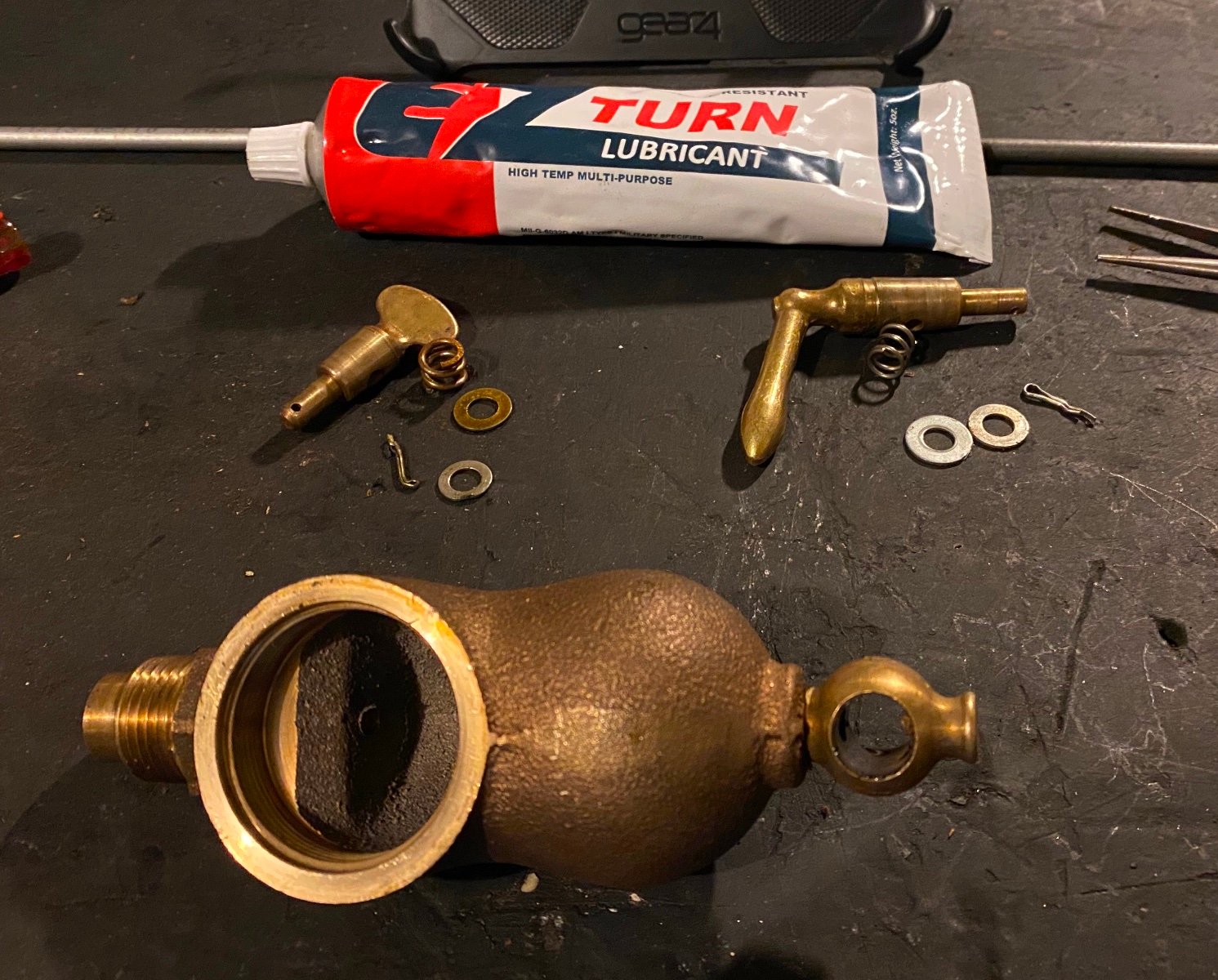

I used a pipe wrench with an extension to remove one from an old tank.
Add penetrating oil and work the bulb in both directions alternatively, loosening and tightening, even if it feels like it's not moving. If it moves a microscopic amount, add some more oil, then keep rocking it back and forth. Every time it moves, add more oil. The oil will slowly work it's way into the threads as you do this and each turn will become slightly bigger.
All of the above is made slightly easier if the tank is removed from the car.
I recently started using EZ Turn instead of teflon tape. It's great stuff...aviation quality...specifically designed for fuel-related fittings. It's not cheap, and the smallest tube is gigantic, but well worth it if you work on a lot of old cars like I do.
1924 Touring

Use the EZLube sparingly on the tapers as it can & will block the orifice to prevent full flow.

I didn't know that EZ Turn acts as a thread sealant too. I have a new sediment bulb for my Runabout and I need to find a sealant. I don't have EZ Turn on hand.

I agree. I used just the very thinnest amount on the tapers. I tested the fuel flow and it's great.
It sealed the threads perfectly.
As mentioned above though...it's important not to overuse it to the extent that it goops up because it's not fuel soluable and could possibly clog up a fuel line.

I'm a big fan of Permatex #2 on NTP (pipe) threads, and EZ Turn on tapered petcock style valves (which is what it's designed for). I have no doubt it would work on threads, but chose not to use it in that fashion.
