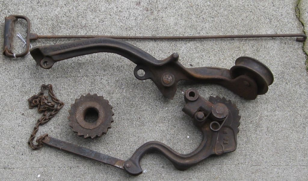

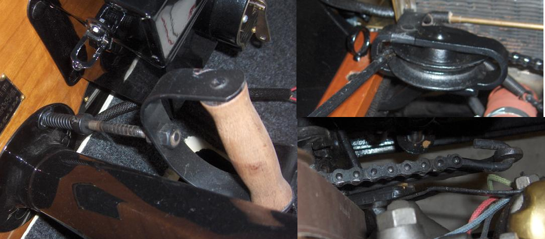

Also hard to find, the mechanical "pull-from-the-seat" accessories. Perhaps that wouldn't do ?

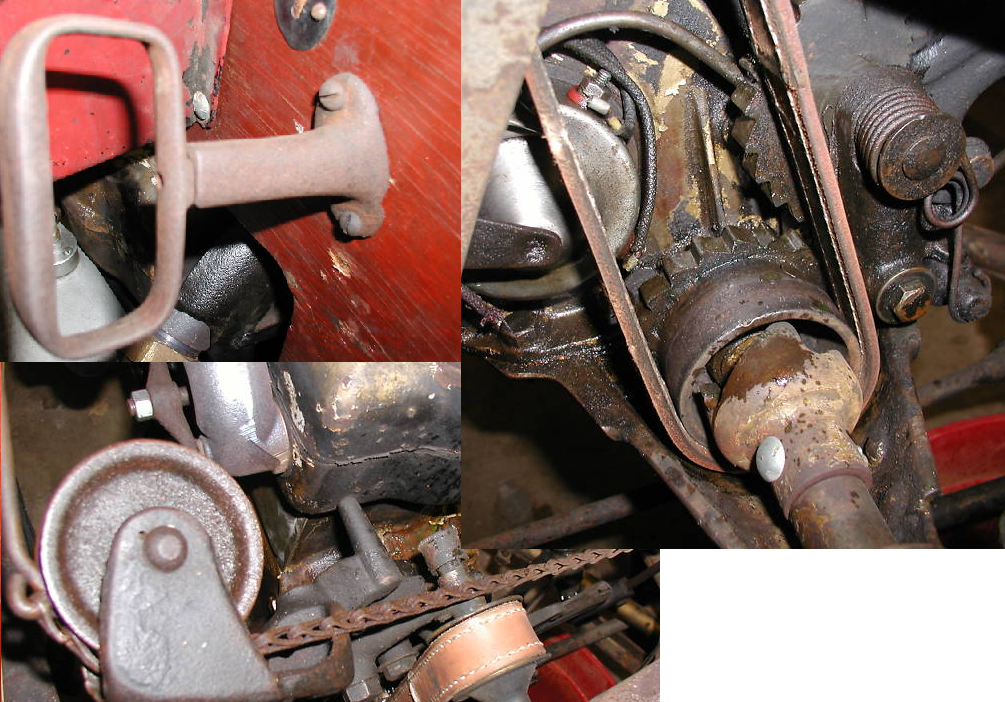

There were several accessory solutions for non-starters
Google search https://www.google.com/search?client=fi ... +acesories
some results
http://www.mtfca.com/discus/messages/11 ... 1288920924 http://www.mtfca.com/discus/messages/118802/124401.html
some results

There must be some tinkerer/engineer out there that could mount a sprocket to a crank pulley & mount a starter motor & cheaper than finding & rebuilding an original accessory starter unit. Although the are a special kind of cool.
Myself, I considered my age & didnt expect to rebuild my 14 motor again, so I added a later starter setup during the rebuild. The H/H is painted with aluminum transmission paint & correct pedals. No one knows unless the left side hood is opened. The original H/H is hanging in the garage for the next caretaker. I have everything in place for the day I am not able to hand crank. Hopefully a long time from now.
Older enthusiasts should consider putting a starter flywheel in while the motor is out in advance of actual need. A starter H/H can be easily added in the future without major motor work. As would have been the case here.

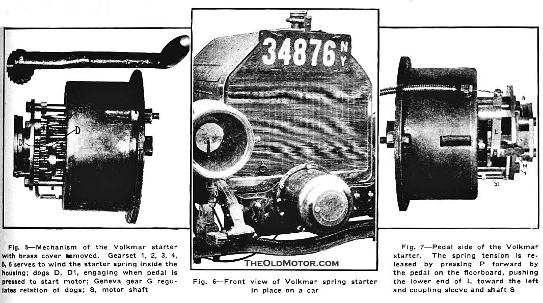

Dave,in the day there were air starters, spring starters, acetylene gas starters and also several makes of electric add-on starters. All pretty novel, and also pretty pricey, unless you get lucky. Lots of foot and and hand pull starter Rube Goldberg type accessories, but with back issues, not sure that would be wise. I have a pull starter I bought from you , and would be glad to sell back, if that isn’t an issue.
In the long run,IMHO, cheapest to add a ford starter and store the removed stuff in the rare chance a purist will care.

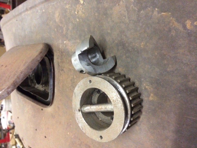

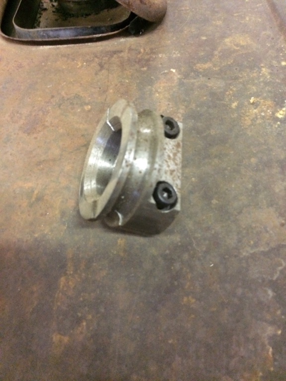

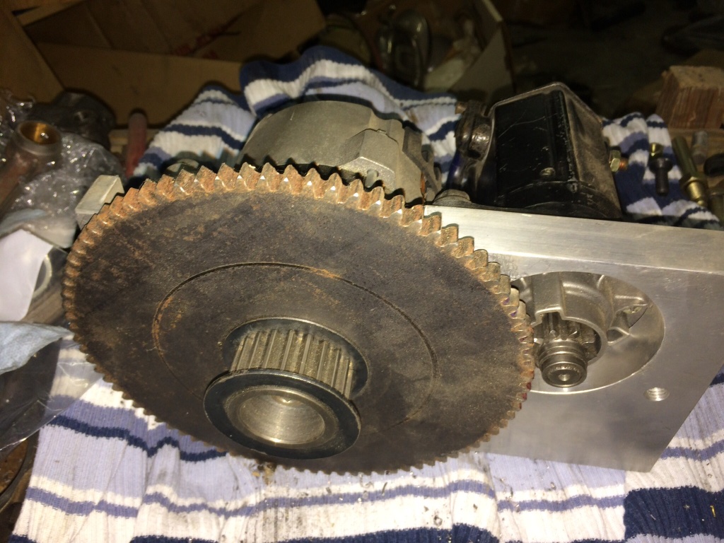

Re: Self starter options for a non starter car

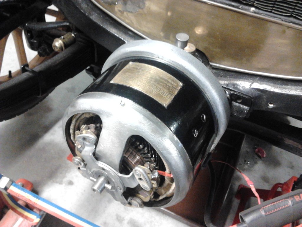

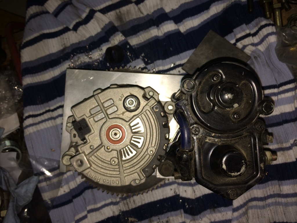

Here are some pictures of a concept I’ve played with. The starter is Subaru. One wire alternator
- Posts: 5579
You really should pursue this endeavor Les - I believe there would be a market for them !

A local T club member who ran an engineering business modified the alloy hogshead on his wife's 1912 roadster to accept a T starter. That way he kept the original look of the alloy cover and its early pedals. He did a beautiful job of adding alloy castings to the cover and machining them for the stater and bendix cover.

That seems like a lot of unnecessary work to do essentially what some automatic transmission paint will doAllan wrote: ↑Wed Sep 22, 2021 5:11 pmA local T club member who ran an engineering business modified the alloy hogshead on his wife's 1912 roadster to accept a T starter. That way he kept the original look of the alloy cover and its early pedals. He did a beautiful job of adding alloy castings to the cover and machining them for the stater and bendix cover.
& arguably, a rare part was sacrificed.

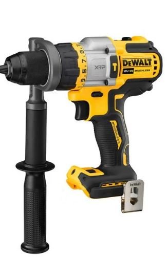

What about something simple? like a drill, change the crank dog to accept the drill chuck or use one of the type with socket square. leave the shortened crank shaft as per the crank handle, connect the drill, start it. lot less effort needed to turn a T motor than the drill can handle,
This one has a long arm making it easy to hold against the motors resistance.

In the past I have seen Everday starters that were made for Model T cars. One was spring loaded and an other was electric starter and generator
in one.
Just look out for one and make it work again.

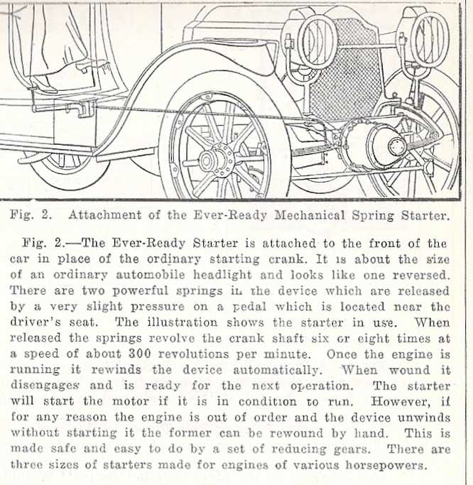

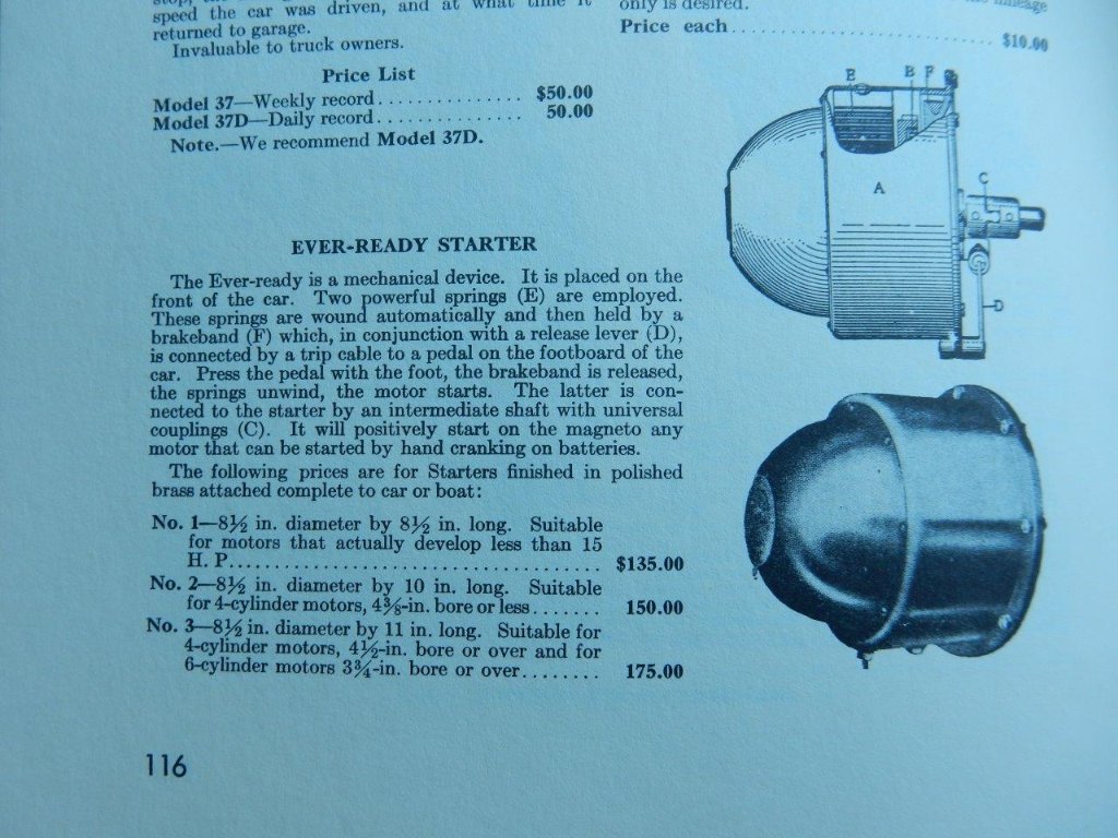

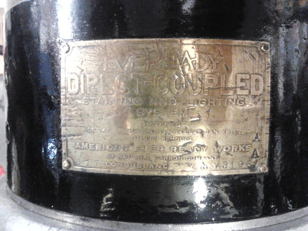

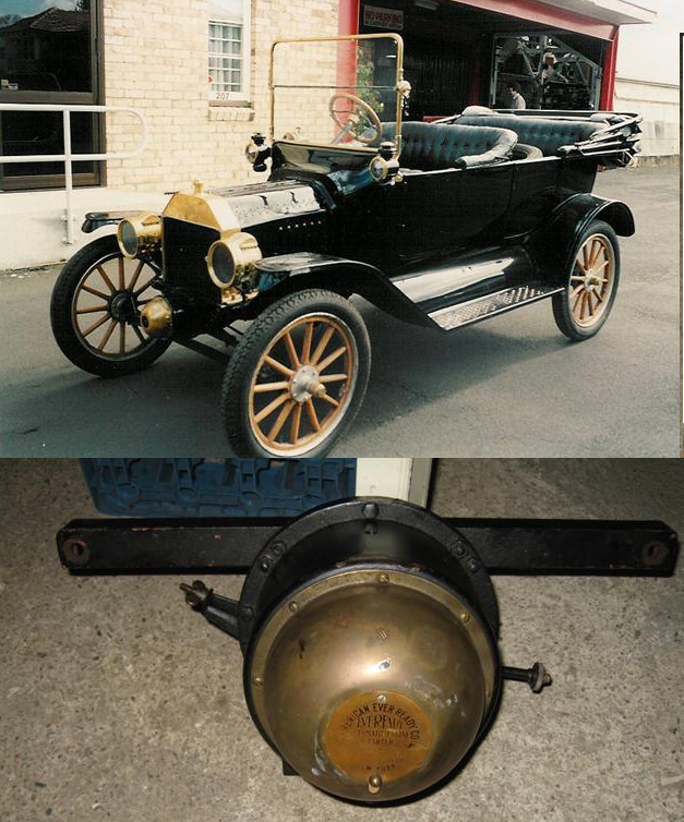

Googled "ever ready starter"
http://www.mtfca.com/discus/messages/29 ... 1196315639 http://www.mtfca.com/discus/messages/41 ... 1390700092

Good question. I'm thinking an early 1950's Ford generator might be up to the task if it had a good battery and heavier wiring to supply it. It could be set up as a starter-generator with a toothed belt drive or a modern flat-type belt and tensioner. Duty cycle would be limited. One of those big Delco generators like were used on Mack trucks would no doubt spin the T motor. They're big, though. It would be possible to offset the weight by using it as an auxilliary power source to boost available HP for a limited time. You'd need a substantial battery and some relays, but you'd have a self starter, a high amp generator, and a hybrid T with some reserve power for hills and other short period transient HP demands. Some regenerative braking would be available. Modifications to the engine and car, if any, would be minimal.

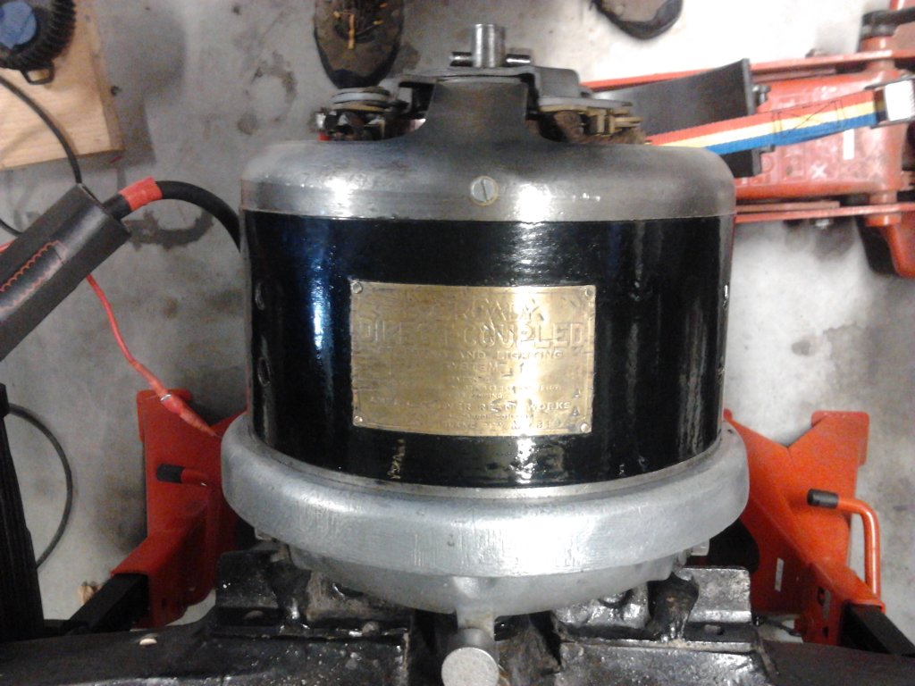

I may regret it someday but I have left the stock Armstrong starter on my 1915. For the past couple of years, off and on, I had a hard starting problem and had to crank a lot for a cold start. Recently I started just jacking a rear wheel off the floor and starting in neutral as a regular part of the starting procedure. I usually get a start with two choke pulls and a third pull with the switch on BAT. A couple of times I even got a free start when I flipped the switch. Of course, starting on battery you don't have to pull fast. Even a slow pull should work. If your cousin can manage three pulls, maybe that can get him by while he searches for one of those rare add-on starters.
