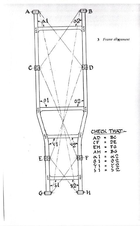

I was cleaning out years of collected stuff and the book "The Restoration of Antique and Classic Cars," 1957, Wheatley and Morgan dropped on the floor opening to page 30. Chapter on the frame and checking it before a rebuild.
For the benefit of the group I am including a copy of their suggestion for making certain the frame is square.
With the Model T Frame being a simple rectangle it should be straight forward to check for squareness.
How many are checking the Frame Alignment?

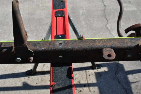

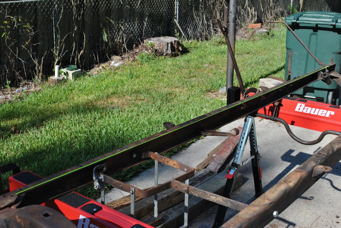

I have found that most Model T frames have a sag where the crankcase ears bear on them. That's easy to check (on a bare frame) using a string along the upper inside edge.

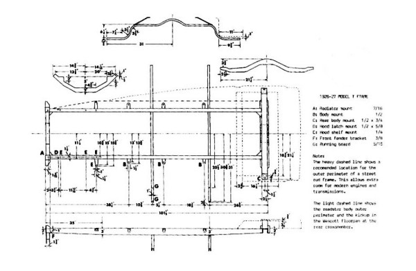

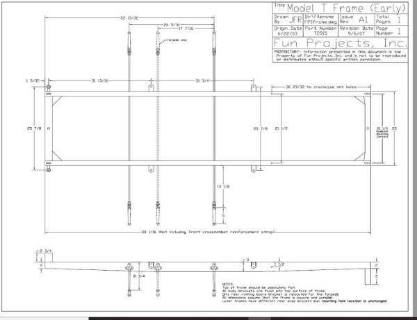

Do you mean like this
Did you mean like this

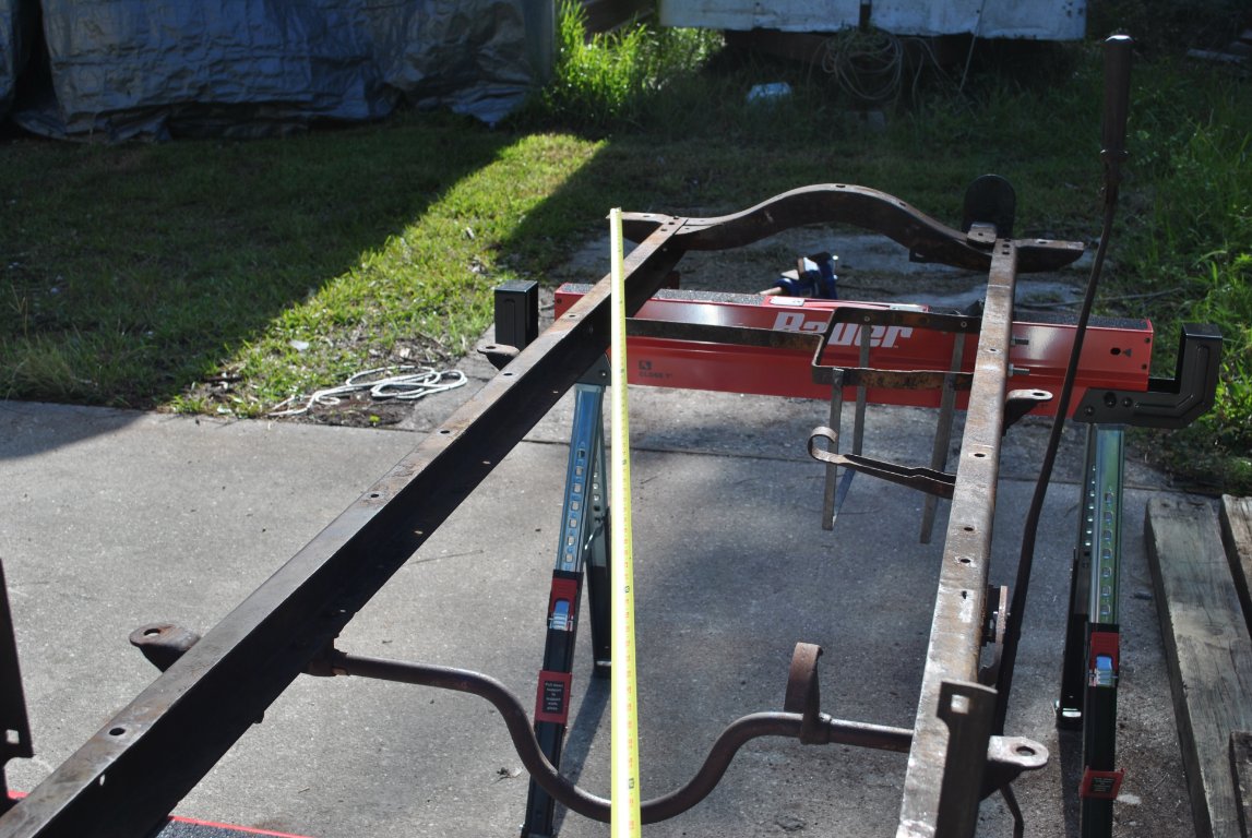

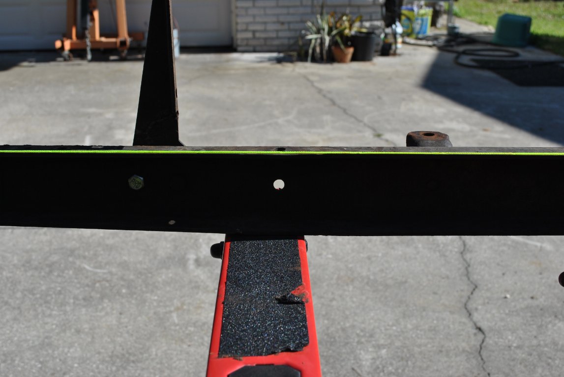

Re: Frame alignment... a suggestion.

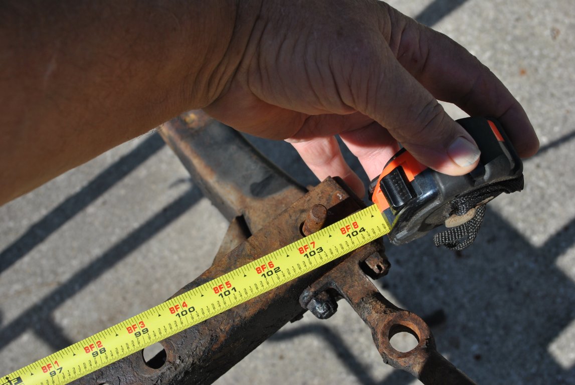

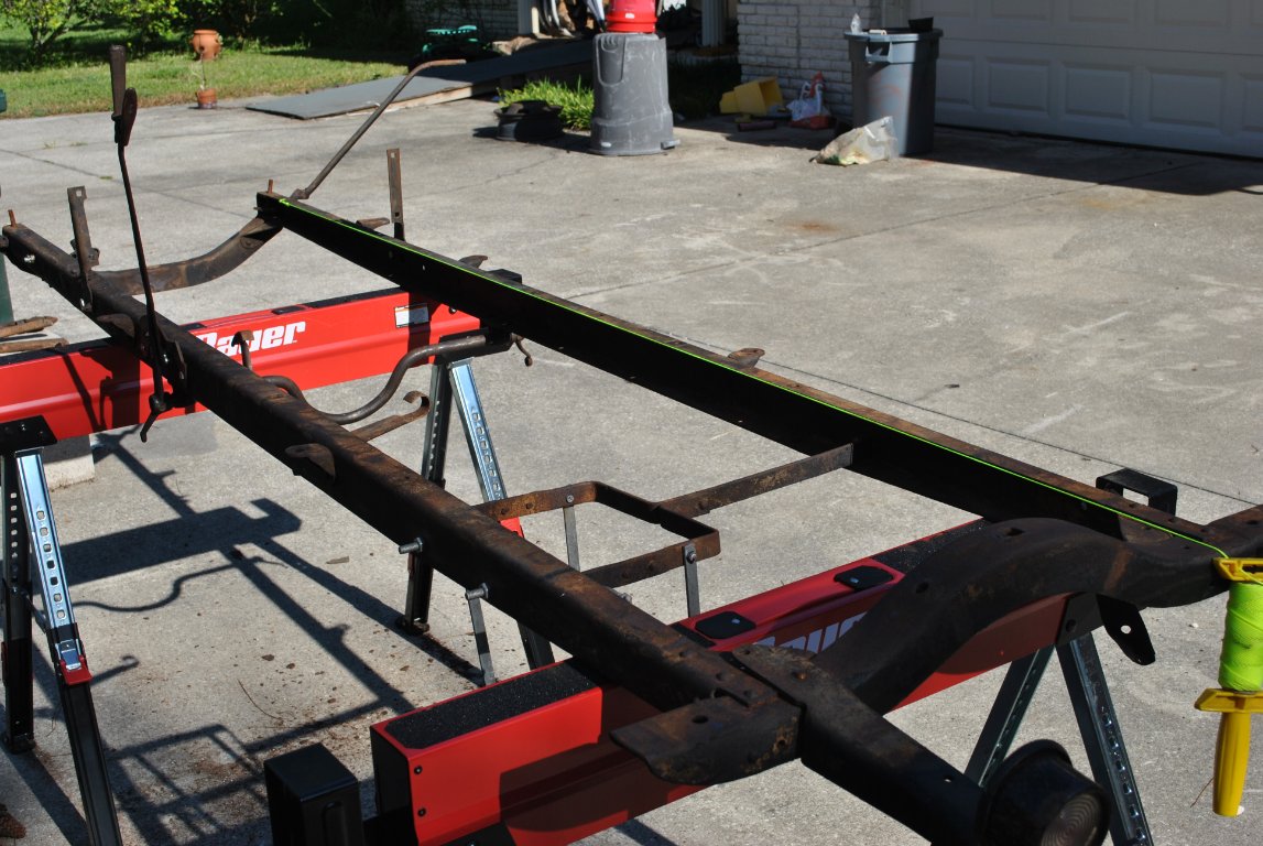

this is how I measured my frame looks straight to me
Passenger side along rail passenger side at location of oil pan ear no sag driver side along rail driver side at location of oil pan ear no sag passenger side extreme rear to driver side extreme front 104 5/8 " extreme driver side rear to extreme passenger front 104 5/8"
did I miss any measurements?
- Posts: 6544
To be complete I think you need to measure if the frame is square. That is is the distance between the rails at the cross members correct to the drawing above and then are the diagonal measurements from cross member to cross member,as described by others, the same.

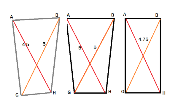

A square frame:
Education and learning are based on mistakes and repetition.
Square frame: AH = BG.
- Posts: 4694
That picture in the above post is not a T frame. The side rails on a T are straight.
- Posts: 6544
The non-model T frame is just used to show where to measure the diagonal lines. If the rails are of equal length then to square up everything (square, trapezoid, rectangle, etc you could measure the angles between the rails and cross members. However, a slight degree of difference can be multiplied at the other end of a long run. The easy way to square things up is to get the diagonal measures equal. So the example below shows an irregular trapezoid squared up and how the same applies to a rectangle (Model T)
Reading my post I forgot two pictures.
I did measure the frame diagonally.
