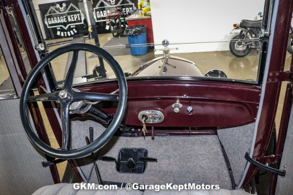

Looking at old photos of Model T’s that are apparently in great or new condition all the colors look shiny and not satin. Of course the photos are in back and white but you can see that they are glossy and not a satin or dull color. When it comes to paint colors on Model T’s there are different opinions as you will soon find out.

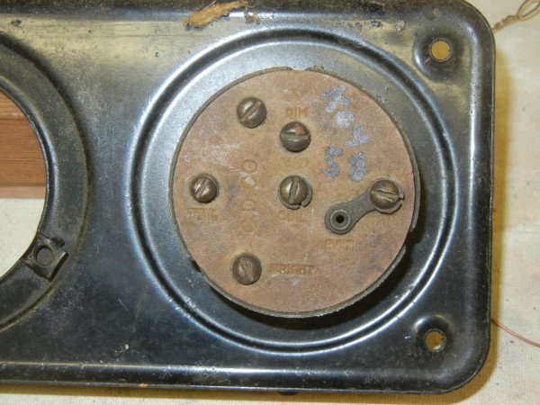

Do with this as you want.
A previous post of the interior, back panel of a Model T Ford switch. To my knowledge this is the black as it came from the factory.
Yes, this is possible an original factory black.
(I would guess with the modern paint analysis to match, it may be possible to approximate original factory black from this piece.)

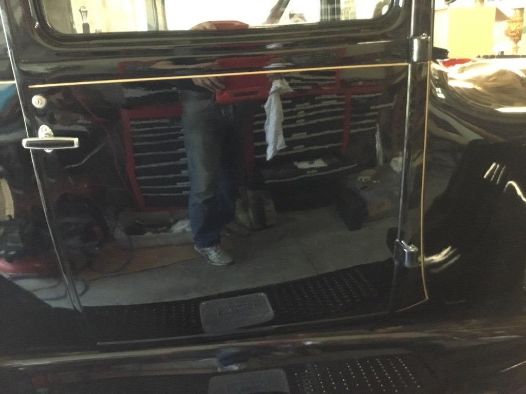

Hi Ed,
Go with gloss black. Are you going to paint it your self? If you are I have found a crutch that works good for me, I use tractor paint. Both my speedster & firetruck are painted with tractor paint. Speedster is John Deere yellow & the firetruck is International Red. A fellow Ter turned me on to this years ago when I asked about the beautiful paint on his speedster (red) I had already painted my speedster JD yellow because the paint came with the parts.
The paint is easy to apply & holds up well. Although colors are limited the same colors the tractor MFG's use. There are some very nice colors. best as I remember there are 2 greens JD & Oliver ( a very nice darker green ) 3 each yellows, blues, reds. 2 greys a white & a orange. There is probably more but not @ the Tractor supply I go to. They also have a hardener for one brand of paint. It's not real expensive $ 50-60 a gallon and they have a primer also. The real nice part is you can buy it in rattle cans and it will match if needed later. If you are having a professional paint it do not mention this post. None of the ones I've talked to will even spray it. it's well below there high standards of paint.
Craig.

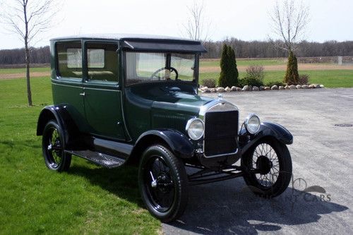

Post by ThreePedalTapDancer » Tue Aug 23, 2022 10:31 pm

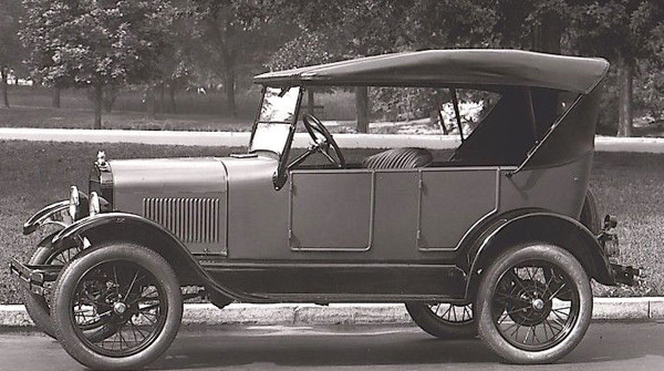

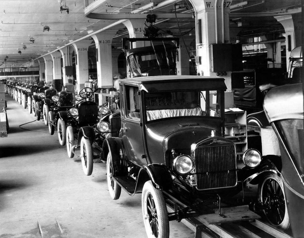

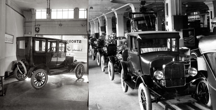

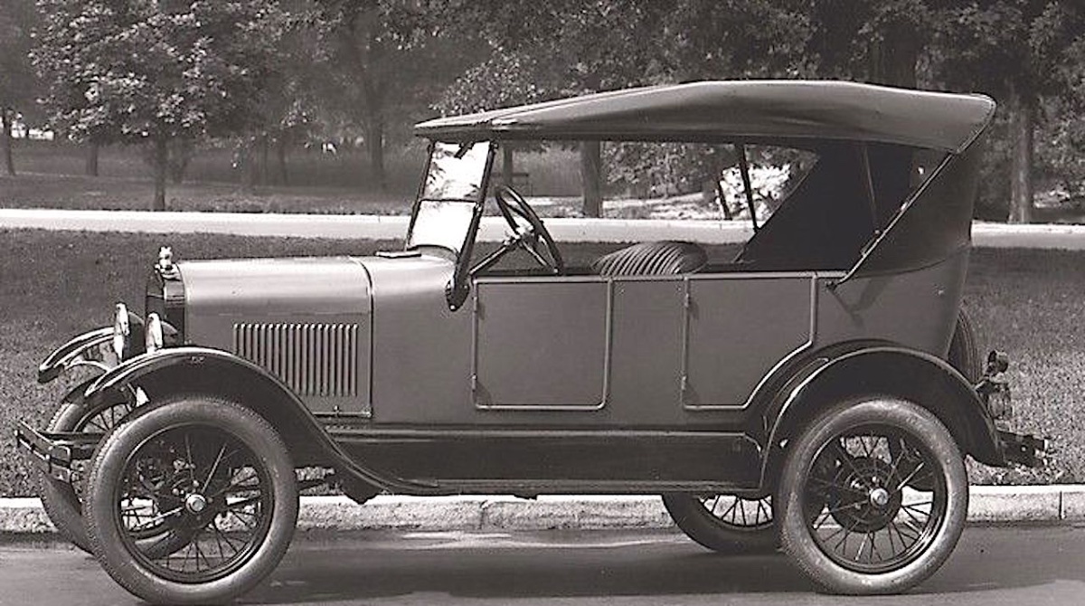

Looking at this photo the body does look satin while the fenders appear glossy.

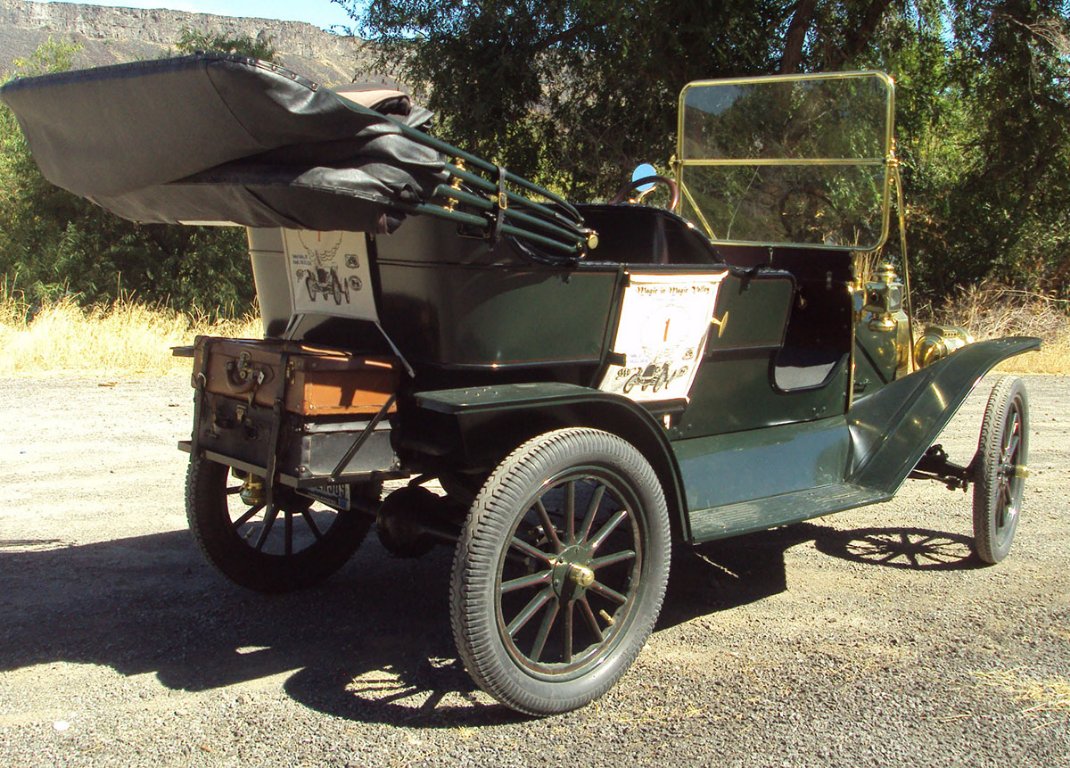

Post by Rich Eagle » Tue Aug 23, 2022 10:33 pm

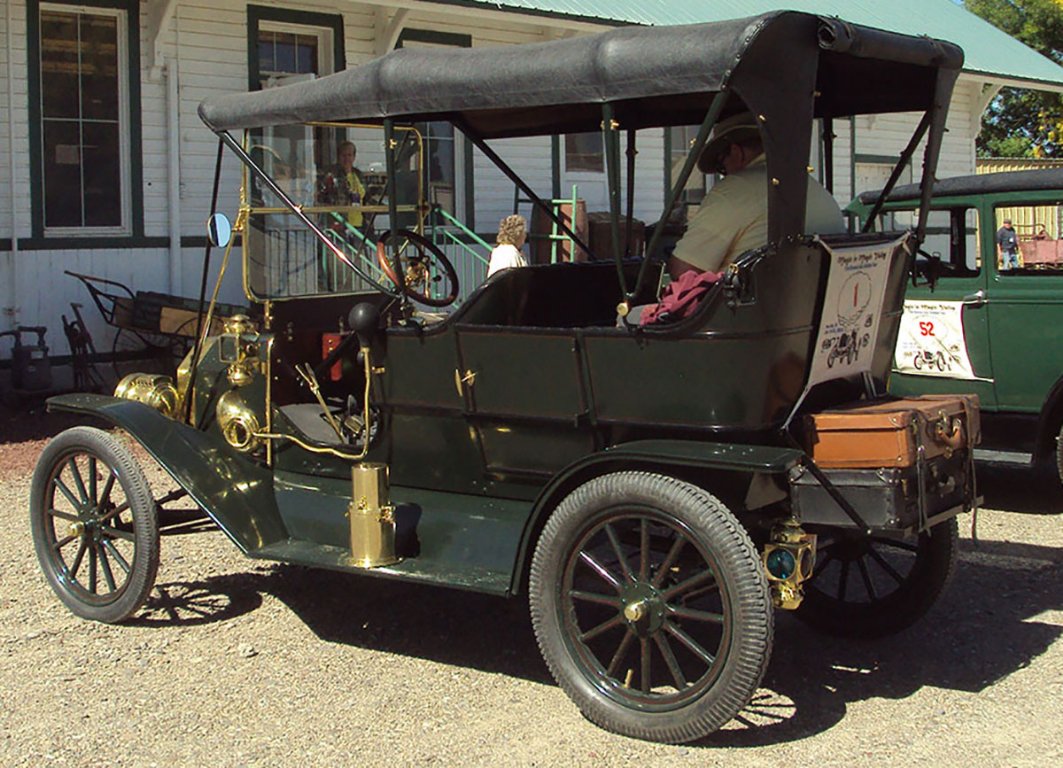

I mixed Van Sickle tractor paint to resemble The Green used on early Ts. It is easy to paint but dries slowly. I found it pretty durable. The gloss is there but not overpowering. Several have mentioned that it has just the right sheen for an old car.
It does depend what you want. I like it.
Someone who mixes paint could get it close to original by mixing a few colors.

I don't think the late bodies were satin. Lacquer doesn't come out that dull ever. The picture might be before the final buffing, not sure of the process. The designation of satin was likely used to distinguish the newer lacquer body cars from the older enamel ones. If you study up on the Ford process for T's and A's you will find that they buffed most of the body parts which produced a high gloss and glass like finish.

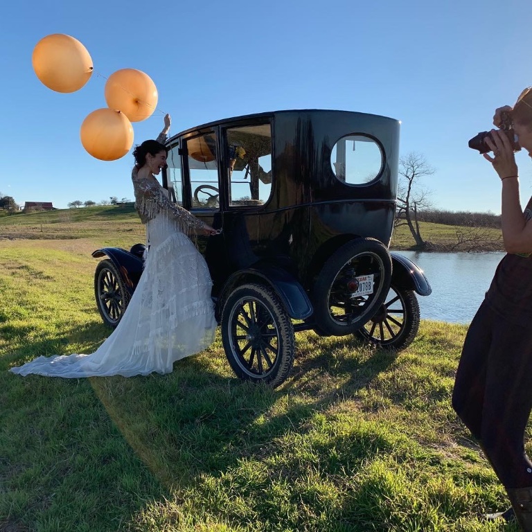

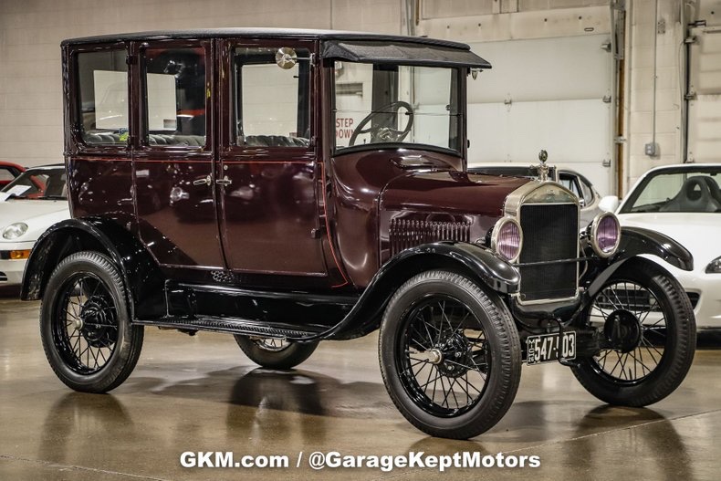

Post by jiminbartow » Wed Aug 24, 2022 3:14 pm

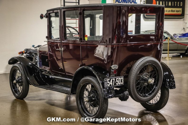

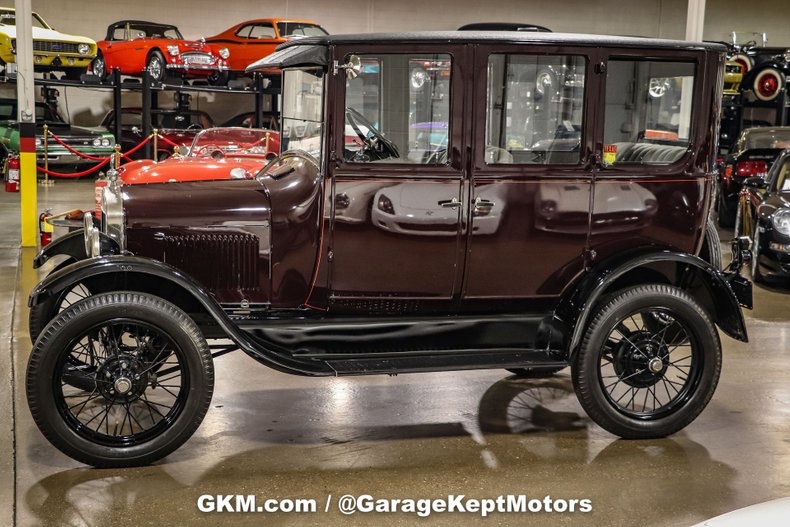

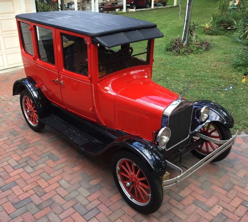

Here is a photo of a nicely painted 1927 Model T Fordor, which would have come off the assembly line like this with a Maroon body, black fenders and grey upholstery with thin maroon stripes. Your 1927 Tudor, which except for having 2 doors looks a lot like the Fordor, would have come off the assembly line with a green body, black fenders and grey upholstery with thin green stripes. Regardless of what Ford says, nothing is chipped in stone and it is strictly up to you as to what color or sheen you prefer. Since I like the maroon much better than the green, if I had a 1927 Tudor like yours, I would paint it the maroon, regardless of what Ford said simply because I think it looks better, will be viewed with much more appreciation by the public and may be more likely to attract interested viewers to get into the hobby themselves. Jim Patrick
PS. Imagine the beautiful highly reflective finish on the car below, as a dull, non-reflective finish and you can come to your own conclusion as to which selection is best for you and the appearance of your Model T’.

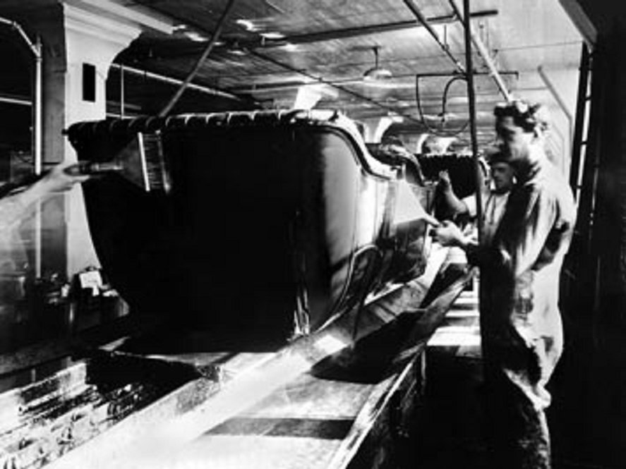

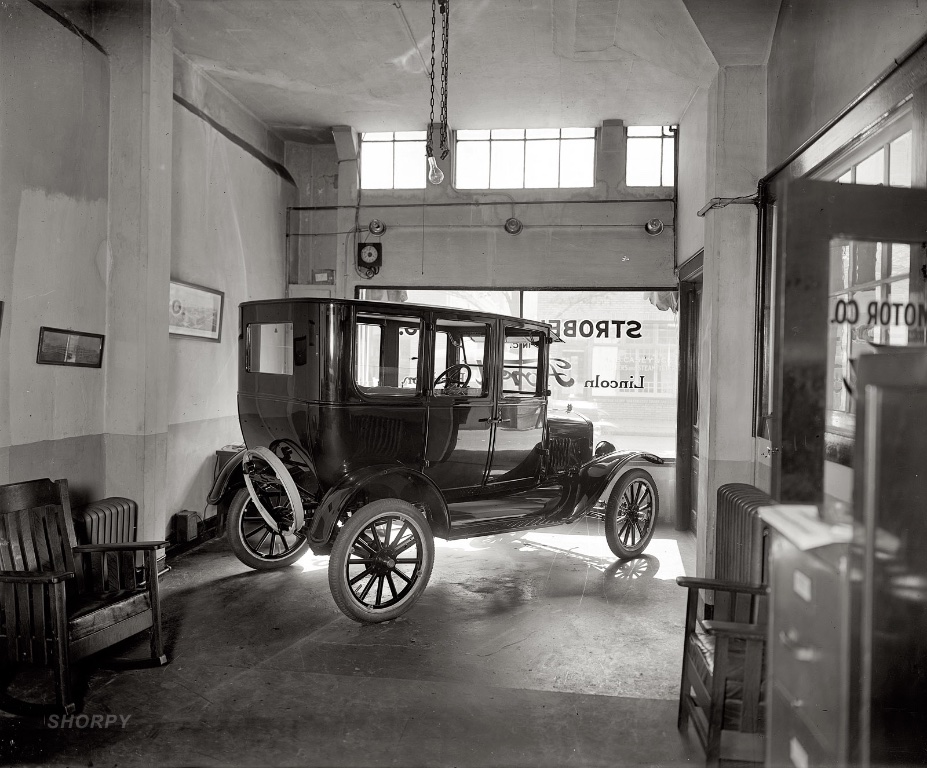

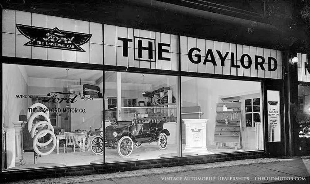

A shiny showroom car may be from polishing as opposed to an assembly line finish

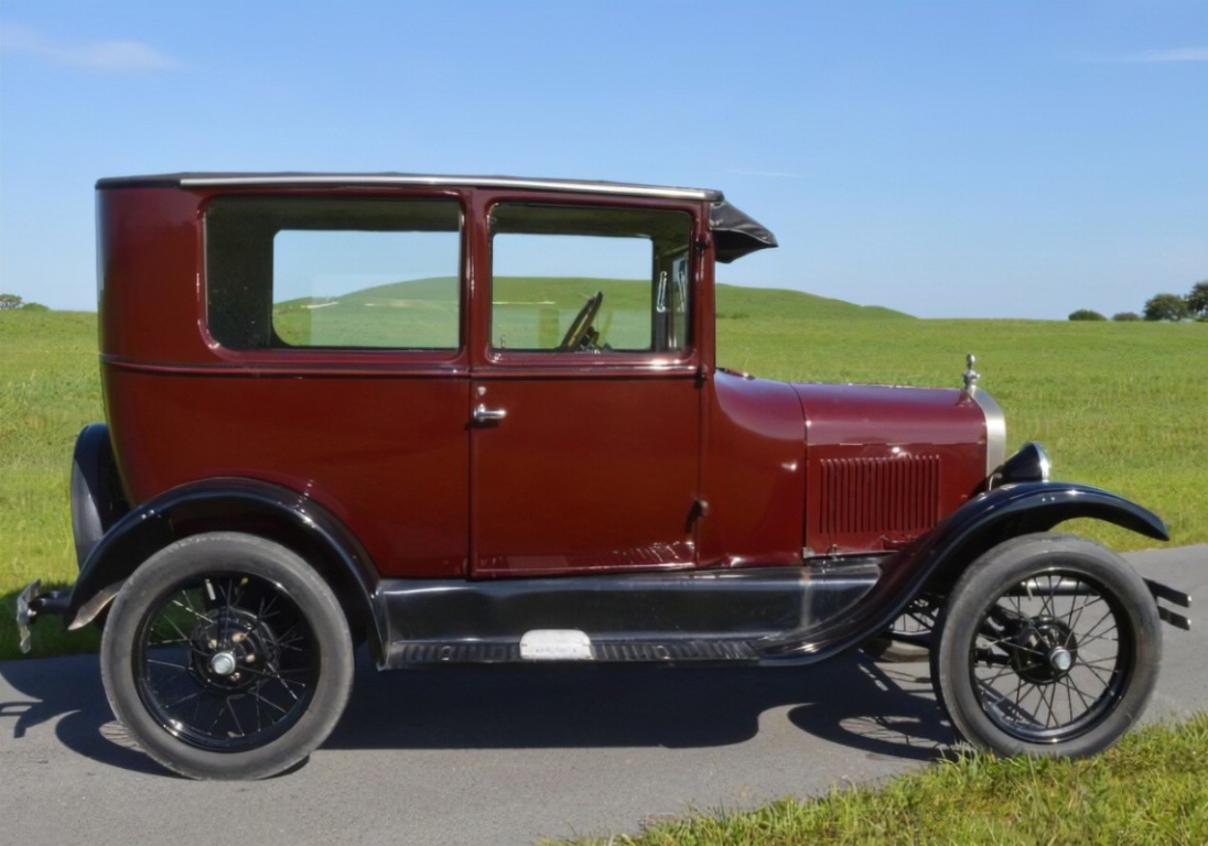

Post by jiminbartow » Wed Aug 24, 2022 5:51 pm
Here is a properly painted 1927 Model T Tudor for you to compare with the Maroon 1927 Fordor to help determine which color you prefer most. Jim Patrick
1927 Tudor painted maroon
1927 Tudor advertisement

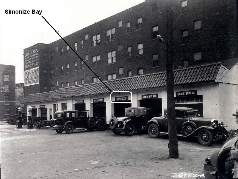

"If you prize it, SIMONIZE it!"

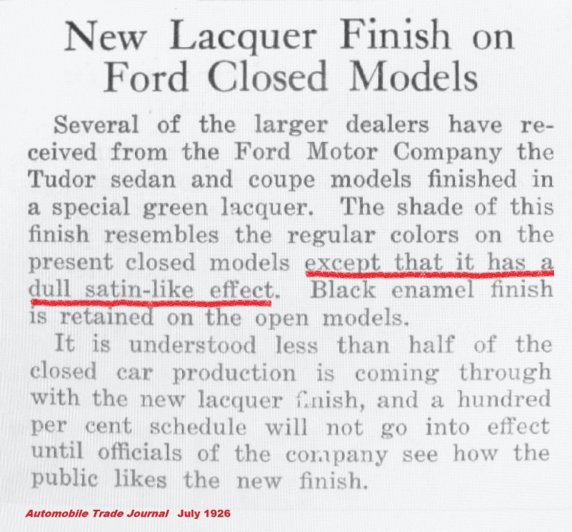

Post by DanTreace » Thu Aug 25, 2022 8:48 am
George Mills wrote:
Wed Aug 24, 2022 4:02 pm
I am going to say that the use of 'satin' in marketing materials could just as well be a relative term. The enamels of the 1926 issue were in fact quite shiny when new as that is what the 'enamel process' was all about.
From the news reports back in 1926 with the 'new' finish on the Fords, the satin term is defined. Have spayed the old time lacquer on a '26 runabout and when coated the finish is satin. Then I rubbed out the finish to bit of a gloss. The Factory didn't want to spend rubbing out labor, so the cars came in satin, that is why you see the difference in old photos, the baked on black enamel fenders stand out glossy compared to the body and hood.
And note the copy that says the new colors are in shades like the 'regular' colors.....those regular were the previous enamel colors.

Post by John kuehn » Thu Aug 25, 2022 9:15 am
So Ford was using the so called satin finish as a test case to see if the public would like it? Thanks Dan for the research in finding those pics and information.
This shows that Henry was grasping at straws to try to keep the Model T from losing sales which came to its end a year later! I’ll bet the dealers wondered about it when they first saw the satin finished cars. And the customers? This was a mistake to be sure and was not a good idea for Henry’s T.
Evidentially the idea went away with the introduction of the glossy Model A’s.

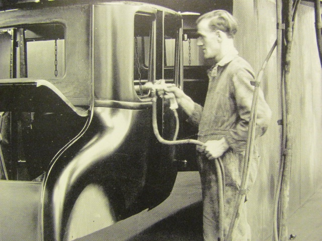

Post by TRDxB2 » Thu Aug 25, 2022 11:04 am
Prior to "spray guns" the cars were flow painted. Excess paint captured underneath, then pumped up above and reflowed, by gravity. Notice the guy on the left doing the back. Picture is circa 1914

Post by George House » Thu Aug 25, 2022 1:23 pm
Very interesting picture of Model T body painting. I’ve never seen that before. Thanks for sharing Frank. I’ve always known paint was fairly flowed on and recovered for reuse - but painted after upholstery applied ? My biggest disappointment in T restoration was stripping original paint off my 2nd owner ‘19 centerdoor and repainting. After seeing the above picture of 2 employees flowing paint, I realize now why there was factory paint runs on both rear quarter panels. On, how I regret stripping original paint.😞

Post by jiminbartow » Thu Aug 25, 2022 9:31 pm
42 years ago in 1980, I sprayed my 1926 coupe with Imron, a 2 part gloss black epoxy that was made by DuPont and it looks like it was sprayed yesterday. Unfortunately, due to ingredients that were banned by the government, it is no longer made, which it too bad because it was the best and most durable paint I ever used. Jim Patrick
