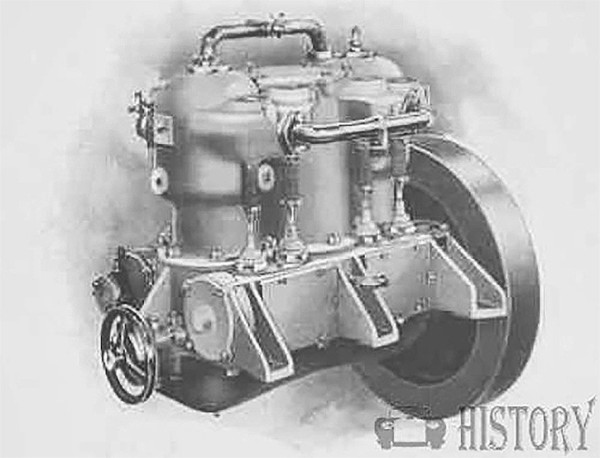

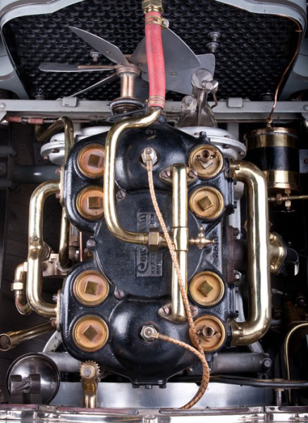

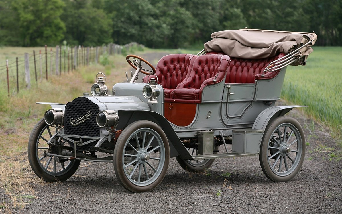

I was impressed by the 1906 Compound car at Harrah's many years ago. It's engine "operated one of its cylinders from the force produced by exhaust gases from the two explosive cylinders. The result was a reduction in noise and saving power". That amazed and amused me.
When I found this video of one running, I thought I should share it here.
https://www.bing.com/videos/search?q=19 ... M%3DHDRSC4

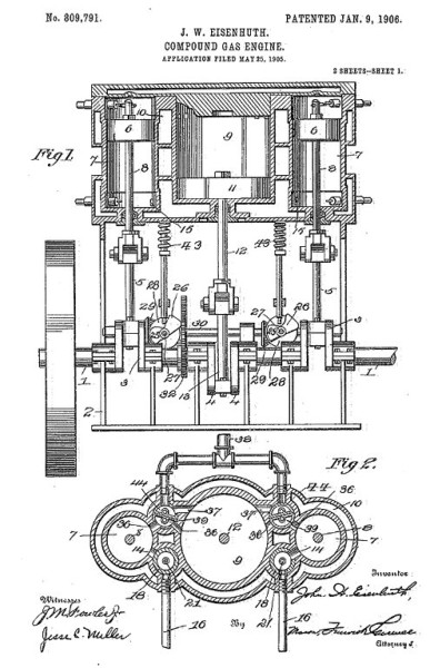

A more elaborate explanation "The outer two, 4-cycle high-pressure cylinders "explode alternately" and exhaust into the larger, 2-cycle low-pressure cylinder rather than into the atmosphere. Here the exhaust gas expands further and drives the piston down before exiting through a small muffler. This compounding of the exhaust gas allowed for more complete combustion that allegedly resulted in a cleaner, odorless and very quiet final exhaust. It also increased fuel economy."
"Of the 300 Compounds produced, this Light Touring Car is the only one known to survive. It is also one of the few cars in the museum whose provenance can be traced all the way back to its original owner, John Unser, chief engineer at the E.H.V. Company. After Unser sold the car in 1934, it passed through a number of owners, including Henry Austin Clark (Long Island Automotive Museum), Harrah's Automobile Collection, General William Lyon, Bill and Doug Magee, and Carl Schmitt. While at Harrah's, it received one of their famed Gold Star restorations."

An interesting idea. Compounding was highly developed in steam engines. The problem with compounding a gasoline engine is not that there isn't a lot of energy in the exhaust stream, but that recovering it via expansion inhibits the function of the cylinders supplying the exhaust stream. It would be very interesting to see an accurate "BTU budget" for this engine.

Double-acting pistons?
