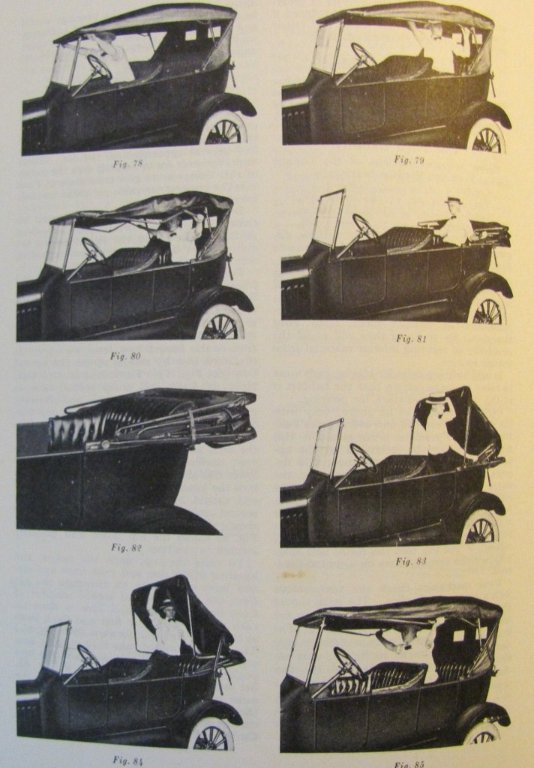

OOPS one man top instructions- the link started out asking for two man top nad then further down was corrected.1925 Touring wrote: ↑Tue Jul 04, 2023 1:30 pmI am probably going to be trailering my 22 touring about 10 or 12 miles and it has the 2 man top.
How do you properly fold a 2 man top? I've tried finding things but all I find are for the 1 man tops.
Much appreciated, thanks!
ONE MAN TOP INSTRUCTIONS pictures & instructions https://www.mtfca.com/discus/messages/1 ... 1321294130

You are correct, thanks for the correction. The link started out asking for a two man top the the instructions were posted. Further down the discrepancy was noted as for a one man top. I corrected my posting aboveCudaMan wrote: ↑Tue Jul 04, 2023 1:57 pmFrank, aren't those the directions for the later "one man" top? The OP is asking about a "two man" top for a 1922 touring.
For a two man top, see this older thread:
https://www.mtfca.com/discus/messages/2 ... 1349658280
