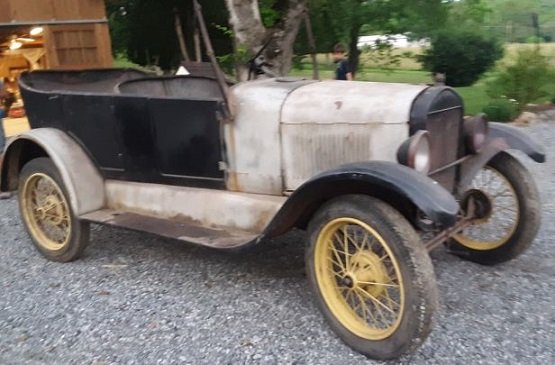

I am 14 and just got my first T. It is a 1926 Touring and I just got it running. Welcome to the awesome hobby!!!
Profile 2.jpg (46.84 KiB) Viewed 3970 times
