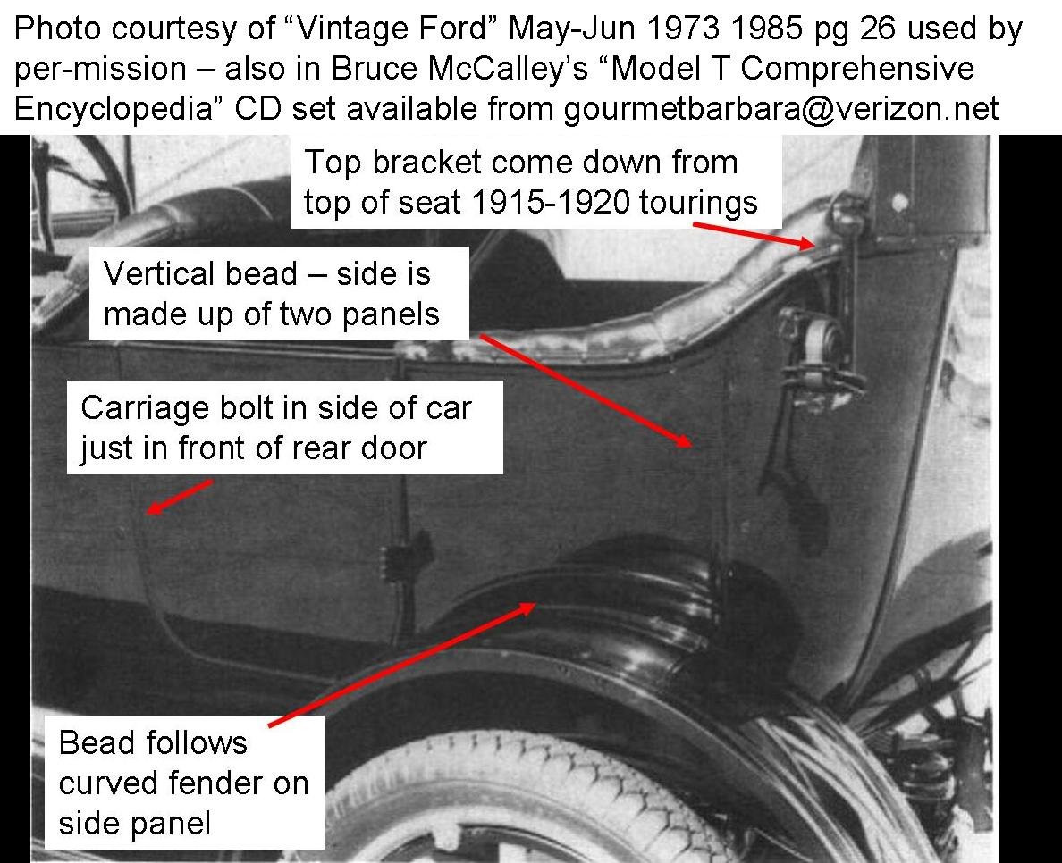

I've also suggested that it might be easier if he obtained a 1917-1920 front section to go with his current 1917-1920s 5 piece rear seat section or that he could obtain a 1922-25 rear seat section to go with his current 1924 front section. In general any rewooding project will take some fitting etc. but I'm wondering how easy or difficult it is to put the 5 piece rear tub on the high cowl 1924 front. Is that about the same effort as fitting the more era correct 3 piece rear tub? I know I have seen a mid-ish 1921-1925 3 panel rear tub fitted to the earlier 1915-1920s car instead of the earlier 5 piece rear tub. And of course the arm rest are wider on the earlier bodies and narrower on the later bodies. And the top rest comes down from the top on the earlier models and out through the side of the body on the 3 piece tubs.
If he wants to continue down that path, does he need to make a custom lower body sill that has the 1924-25 high cowl dimensions etc. in the front and for the rear, make the sill have the 1917-1920s 5 piece style sill dimensions and additional wood bracing so the earlier rear tub will be properly supported?

I like to say the rear tub changed during 1921 -- when I believe both the older 5 piece rear tub was replaced with the newer 3 piece rear tub. The 2 photos below show a 1919 5-piece rear seat section for a touring (used by permission of Model T Haven -- this one sold several years ago. Thank you Mark for letting us use those. See https://vintagecarsandparts.com/cars-pre/cars-pre-2 for other photos on his site. )

Well you could ‘sort of’ fit the 5 piece earlier rear section on a 24 Touring front half but it wouldn’t be quite right. Believe I would try to find a 17-20 front half to go with the 17-20 back half. Or find 24 back half to go with the 24 front half.
