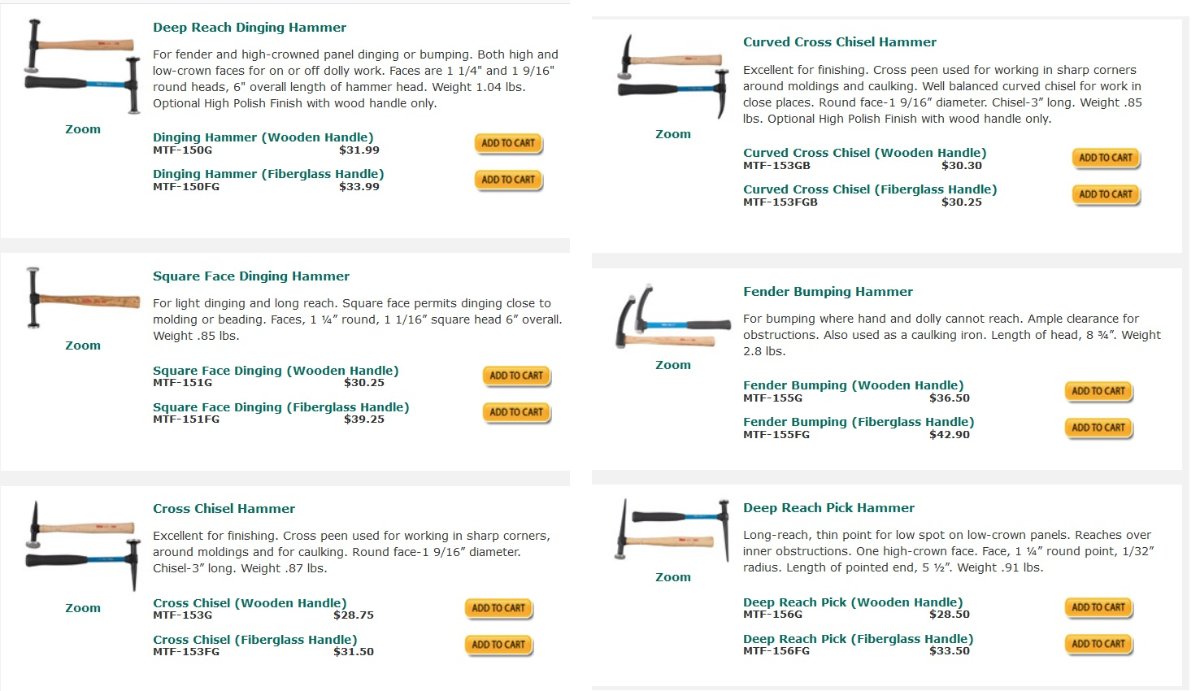

Lists purpose of various hammer styles ...https://www.tinmantech.com/products/han ... y-hammers/
Which styles make sense for Model T work.? Sometimes a "kit" contains stuff you'll never use.
