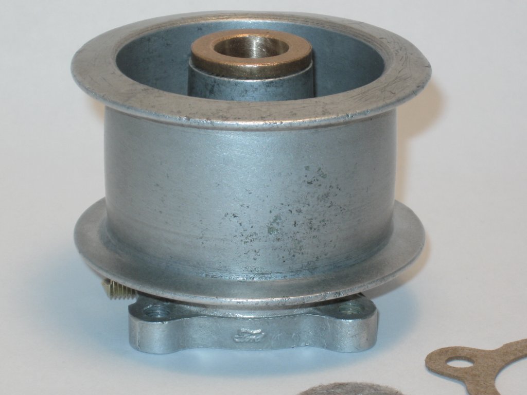

				So I put on a new flat tube radiator and can't adjust the spacing of the hood properly.. the problem is I only have a half inch between the fan and radiator.

				I see you have a ‘26. You might have a long fan hub for a thin core, and the new radiator is a full thickness core. You might need to just find the short version of the fan hub.

				What era fan and/or bracket? 1909 to about 1919? About 1918 to 1925? 1925 to 1927?  If 1925 to 1927, which of at least three variations?
The brass era brackets are almost fool-proof. The about 1918 to 1925 brackets can actually be put on backwards. I forget which way does what, but the forward to back placement does shift a bit. The late 1925 through 1927 variations get more complicated. Also, there was a longer fan hub used for awhile that moved the fan closer to the radiator, (the radiator being used for a short while was thinner and needed the fan moved forward).

				namdc3 wrote: ↑Sun Apr 04, 2021 5:59 pm
That is a long fan hub.  It goes with a thinner core.

				You need the shorter version fan hub. You can call Lang’s tomorrow and ask if they have a good used short version.  They also sell the newer ball bearing hubs that might fit but they would cost a bit more than an original used on. They do have a supply of used parts.

				I have a bin full of hubs - drop me a note.

				You need the correct fan hub. Also, the fan and hub should turn freely on the shaft, but there should be no wobble.
