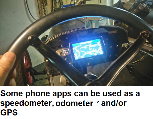

Phones can assist in driving.
Some can be used for driving too :lol:
Helps on the job
They can drive you crazy too :shock:
