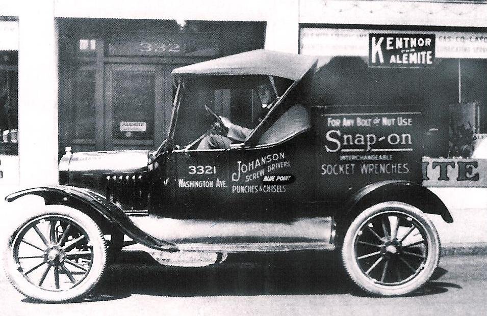

Here is another option. There are several salesmen boxes out there. I know where one is. Think it would be unique and cool looking on a Torpedo.
http://www.mtfca.com/discus/messages/11 ... 1293029919
http://www.mtfca.com/discus/messages/80 ... 1247510850
