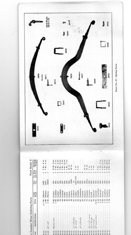

This illustration shows the boss lug, with is used for lathe turning, that boss must be to the rear of the axle.

The left front perch is odd numbered 3819 and right is even 3818. On a Model T all odd numbers are left and even numbers are right where there is a left and right part.
