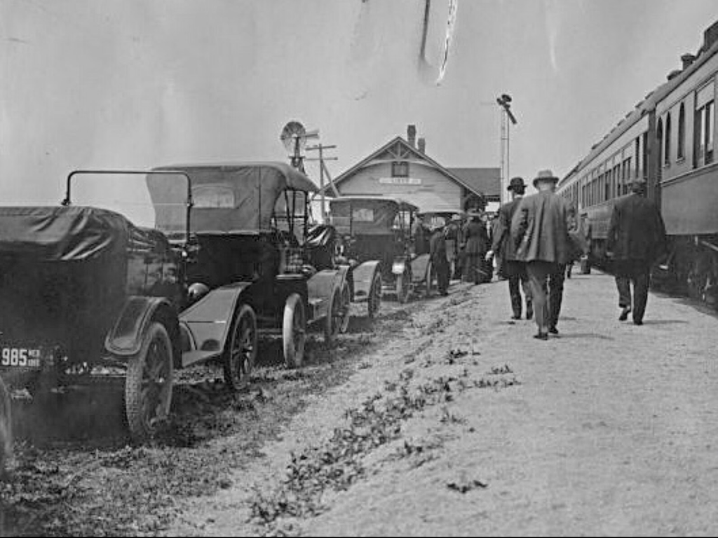

by hull 433
Here's an early 1916 Ford with 1915 plates. It looks like the flaps were gone by late calendar 1915.
