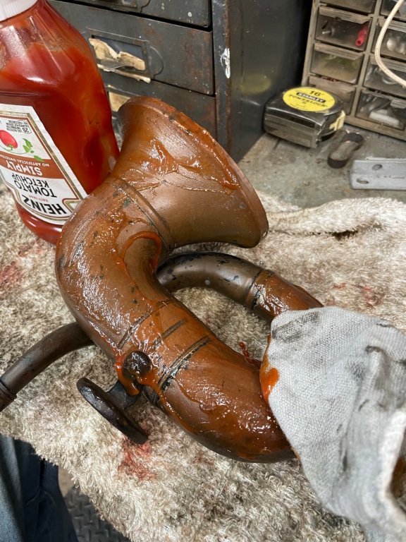

Easiest way found for me to remove the very old brass tarnish is ketchup :)
Really works, slime it on, rub with a rag and the tarnish is gone. Clean well in soap and water rinse, then go on to polish using your favorite product.
Re: Brass cleaner suggestions?
Posted: Thu Jun 16, 2022 9:09 am
by TWrenn
:lol: And I love ketchup on certain things...but wonder what it's doing to "our pipes"!!
