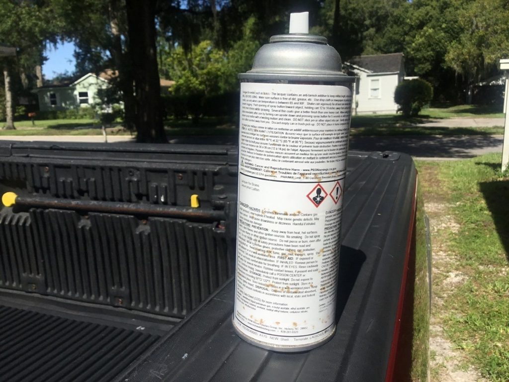

Post by jiminbartow » Tue Jun 14, 2022 8:44 pm
Some polished brass was sprayed with a coat of lacquer to preserve the shine, but, overtime, this lacquer dulls and darkens. Until this old lacquer is removed, any polishing you do will be to the surface of the lacquer until you polish through it to the underlying brass, at which time the brass will begin to shine. This is very time consuming. Better to remove the lacquer with lacquer thinner before attempting to polish the brass. Jim Patrick

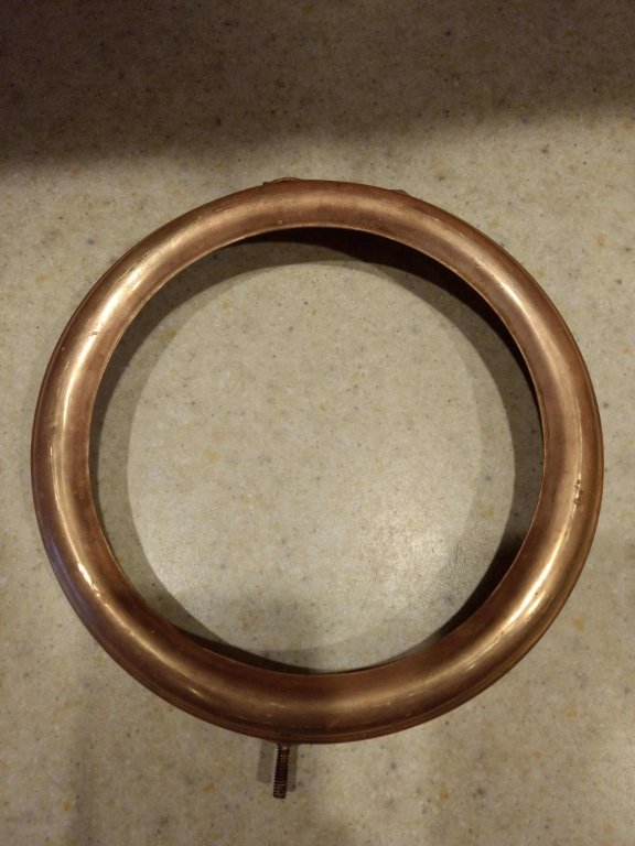

Post by NealW » Wed Jun 15, 2022 10:08 am
Craig Leach wrote:
Wed Jun 15, 2022 1:46 am
How corroded are you talking about?
Craig,
here are the door sill pieces as an example. The other brass pieces are dull and brownish looking, but not corroded as bad.

Post by Craig Leach » Wed Jun 15, 2022 10:48 am
Hi Neal,
Pat is correct about exposure. I used Zepp because it is stronger than vinegar. If you use vinegar try the commercial grade it's more like 30% -35%. Many of the polishes are acidic, I like to wash & wax after polishing.
Craig.

What is the best polish to use for brass after cleaning with Flitz?
jiminbartow
Posts: 2485
Last Name: Patrick
Location: Bartow, FL
Re: Brass cleaner suggestions?
Post by jiminbartow » Thu Sep 15, 2022 10:45 am
Once you polish your parts, you can preserve the shine with Mohawk Lacquer spray. It goes on great and, unlike most protective sprays, dries crystal clear with no fogging. Try it and you will never use anything else. Jim Patrick
