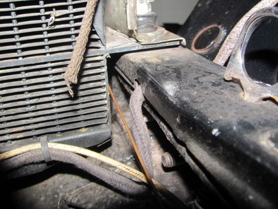

Here is a photo of the bolt on the top side of the fender of a 1926, just in the upper right corner of the photo you can see the carriage bolt we were talking about.
I just was not sure if the fender was stamped with a square hole for a conventional carriage bolt or just a standard drilled hole that would require that bolt to have no square underneath the head of the bolt.
It has the same shape dome to it as the hardware that holds the headlight bar onto the fender as well.
Hopefully this answers your question about the bolt on the top. We do have some standard carriage bolt that would work there if you have the square hole in your fender. We do not have any bolts that do not include the square though.

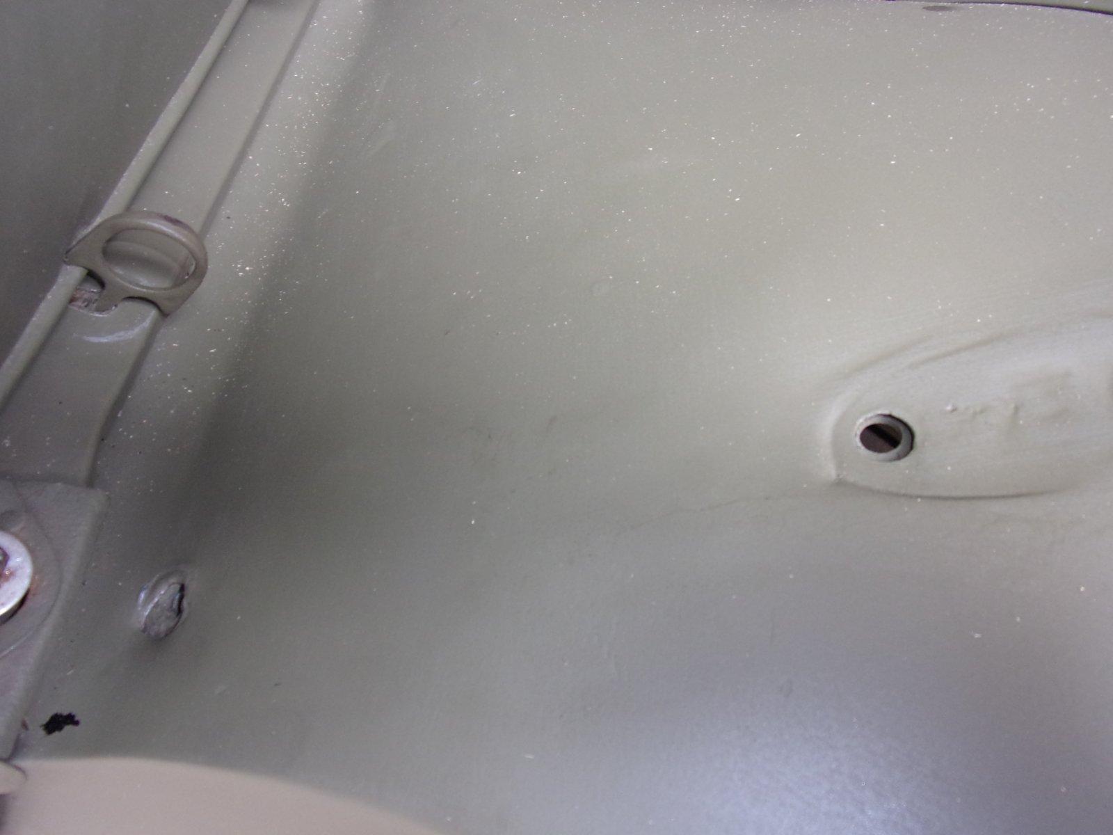

Forgot I took two original front fenders to Dan Hatch and didn't have them laying around to photograph. Removed replacement bolt I had installed and took pic. Feels like round hole and round hole in frame bracket as well, so no square shouldered bolt. I did have a few slotted button head bolts that look like carriage bolts but do not have square shoulders. Will only tighten as much as friction allows, but it's the correct appearance, I presume.

This earlier post will help. Photo shows accessory Ford bumper bracket using one of the frame bolts to th fender bracket. The top hole is for a large head carriage bolt that fasten the fender, the fender hole is usually worn too by this carriage head bolt, paint the head same as the fender,
