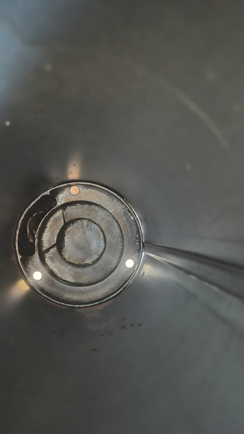

Was able to salvage my cast iron ends.... would like to reuse them with a new shell kit (3-bolt).
will see if I can get a little more knocked off them, then maybe paint them with high-temp paint (black)
So if I go with this kit...
Are there any tip/tricks to getting a good seal?
Would you use something JB Weld High or Extreme Heat epoxy on the ends?
...maybe a jam nut on the ends of the bolts..

Your cast iron ends look to be in great condition. Give them an overnight soak in something like Ospho to help descale
(Might be anal, but after soaking in acid I always neutralize by following up in a water bath with baking soda, then rinsing). Paint as you will with high temp..
I recently bought a new shell kit for my '14 3 bolt cast iron ends.
First thing I noticed was the shell bows out at the seam sufficiently where a tight seal would not be attained, creating a major exhaust leak at both ends.
I did NOT want to use something more permanent/hard like JBWeld to fill the gap, that just spelled major hassle down the road in my mind. I used a high temp RTV (way easier to remove than JBWeld, but also flexible)... I used Permatex Optimum High Temp RTV. Hopefully I never run too leaned out to glow that muffler past 750 degrees.
Perhaps others have different solutions....

Spot welding worked for me. No more cobbling the thing back together out on the road. I knew it would last for years, and if it eventually went bad another new one wouldn't break the bank. I would spot weld that one too. A man's gotta do what a man's gotta do.
