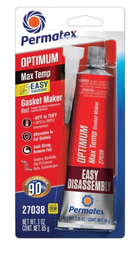

Your cast iron ends look to be in great condition. Give them an overnight soak in something like Ospho to help descale
(Might be anal, but after soaking in acid I always neutralize by following up in a water bath with baking soda, then rinsing). Paint as you will with high temp..
I recently bought a new shell kit for my '14 3 bolt cast iron ends.
First thing I noticed was the shell bows out at the seam sufficiently where a tight seal would not be attained, creating a major exhaust leak at both ends.
I did NOT want to use something more permanent/hard like JBWeld to fill the gap, that just spelled major hassle down the road in my mind. I used a high temp RTV (way easier to remove than JBWeld, but also flexible)... I used Permatex Optimum High Temp RTV. Hopefully I never run too leaned out to glow that muffler past 750 degrees.
Perhaps others have different solutions....

Daisy Mae wrote:
Tue Aug 26, 2025 1:13 pm
this looks promising!... thanks for the info.
