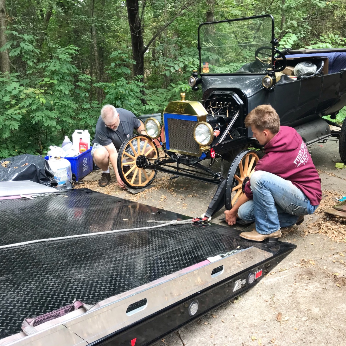

I recently had a “ locked up “ Model T to pick up on a Sunday kinda out in the sticks.
This Model T belonged to Ken Jones in Minnesota who passed earlier this year - KD used to clean and polish as a kid growing up in Washington state.
This Model T started it for Kim .... :mrgreen:
Larry ended up buying the car to finish restoration.
Like every Model T that I haul - it had an important history .... ;)
It also had no tires - but nice wooden rims that the new owner had tried to protect with blue painters tape.
I called out a rollback tow truck.
We used floor jacks on the rear pumpkin and front axle to lift the T on wood blocks to get it from the rear garage on the property up to the driveway where the rollback could grab it and carefully winch it onto the deck using skates.
Then we transferred it into my enclosed trailer.
This took a few hours - but no damage was done.
There is no substitute for Care and Experience.
FJ

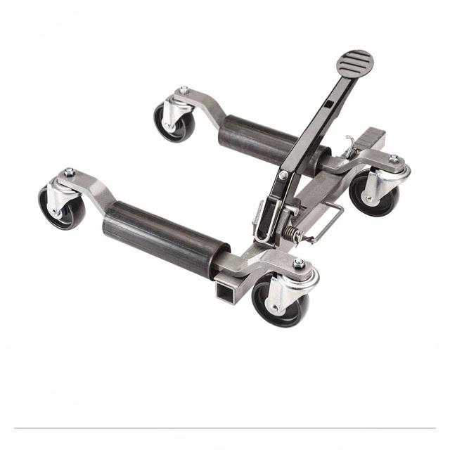

I am fairly new to T's, but I don't see how it can be good to force the engine to turn over by towing a T.
And I don't see why loading or unloading one without forcing the engine and drivetrain would be complicated.
But I will soon be unloading one with a locked up clutch, so maybe I will find out first hand just how deep my ignorance is.
I have wheel dollies to put under the rear wheels when I back it off the trailer. Once off I will remove the rear axle keys so I can push it up the driveway. Maybe I am just too stupid or too ignorant to understand how this is a difficult thing to do. And maybe it is not necessary, but it looks like the professionals take the extra time to do it.
I don't see anyone posting to just roll it like it is, so I guess the little extra trouble I will go to is justified.

Visited this original custom bodied T in south FL, to help the neophyte owner get a grasp of what the Model T is all about.
When there, he said it took 4 large guys to push the T into the garage as the 'clutch was stuck', that is what the delivery hauler guy stated, he had a hard time winching it onto his rig.
Well, that was not the case, they just didn't pull to center the emergency brake/clutch hand lever for 'neutral'.
They all thought hand lever forward was the rear brakes off :?
I showed him to pull back the lever to middle spot, and pushed it easy. So, you never know :D

I use dollies in the shop to line up cars for the winter...they're great if you buy the ones with cast iron wheels (they won't flat-spot over time). I'd be leery of using them on an incline, though. Too much slope and things can get away from you. If that's not an issue, then that's not an issue.
Again, good luck.

To Clarify:
Wheel Skates
Used by commercial tow companies to slide a non-rolling vehicle onto a rollback or other tow platform - they slide on diamond tread or aluminum deck or smooth asphalt/concrete roadways.
Typically used at accident scenes.
Wheel Dollies
Typically used on smooth & level hard floors to move a vehicle easily within a confined space.
Both rely on the weight of the vehicle & a smooth and level surface - neither device has a design provision for attachment to the wheel to keep the device secured that I have seen.
In the real world - when you are trying to move a lightweight vehicle that is locked up using either of these devices - on a broken or rutted surface that is not level - the vehicle has a tendency to fall off the device.
In the case of a Model T on nice wood rims with no tires - this can damage the wood rims.
Even with a person at each corner of the vehicle - it can prove difficult.
