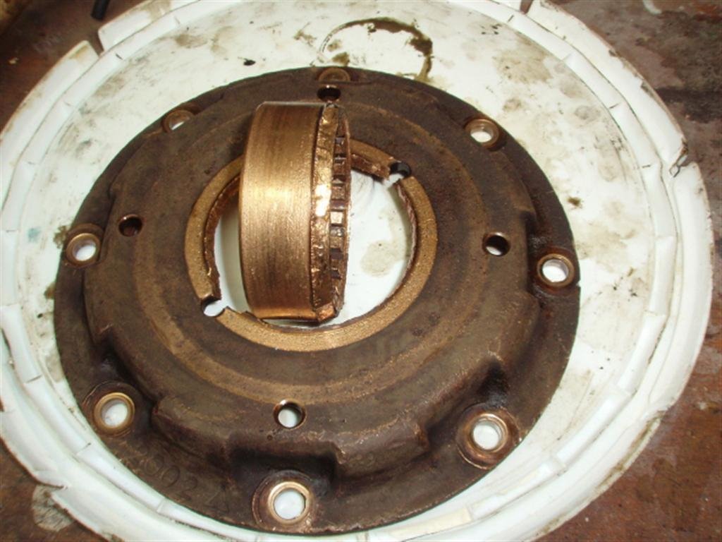

Could be a broken bronze gear casting. That broke on my TT and I had the same problem - no more standard drive, only low.
It also gives a nasty 'neutral' if you shift into standard, no braking either in that case.
Tear down and see if you can replace the casting if possible. It usually cracks near the hub (see picture).
A MUST is to get the MTFCA booklet on Ruckstell rebuild. FOLLOW it carefully and you won't go wrong.
Note, Ruckstell has 'standard Ford direct' and 'Ruckstell Low', so there is not really a 'high' as such.

Adrian
Thank you for the correction and the pictures I knew in my head it should be termed Ford standard and Ruckstell low but was writing high gear will try to keep the terminology correct. Once we start to get into it will keep you posted as to what we find.
